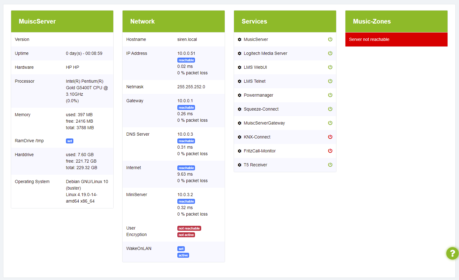

    13.1.0 not seeing music-zones
    You can see from the dashboard page:
Name: Annotation 2021-02-28 084913.png
Ansichten: 444
Größe: 89,9 KB
    I can see the zones on Spotify with Spotty, so they appear to be working.
    Attached my support data. (FYI this is my production server using Deb 10, not my staging which is where I have Deb 11)

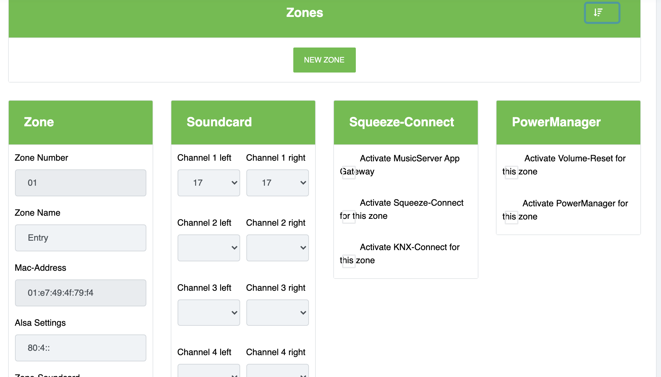

          I can't select other zones besides Zone 01. I tried saving that one and it doesn't show up on the front either.

          PS: My staging (Deb 11) has the same problem but I haven't set up any zones yet.

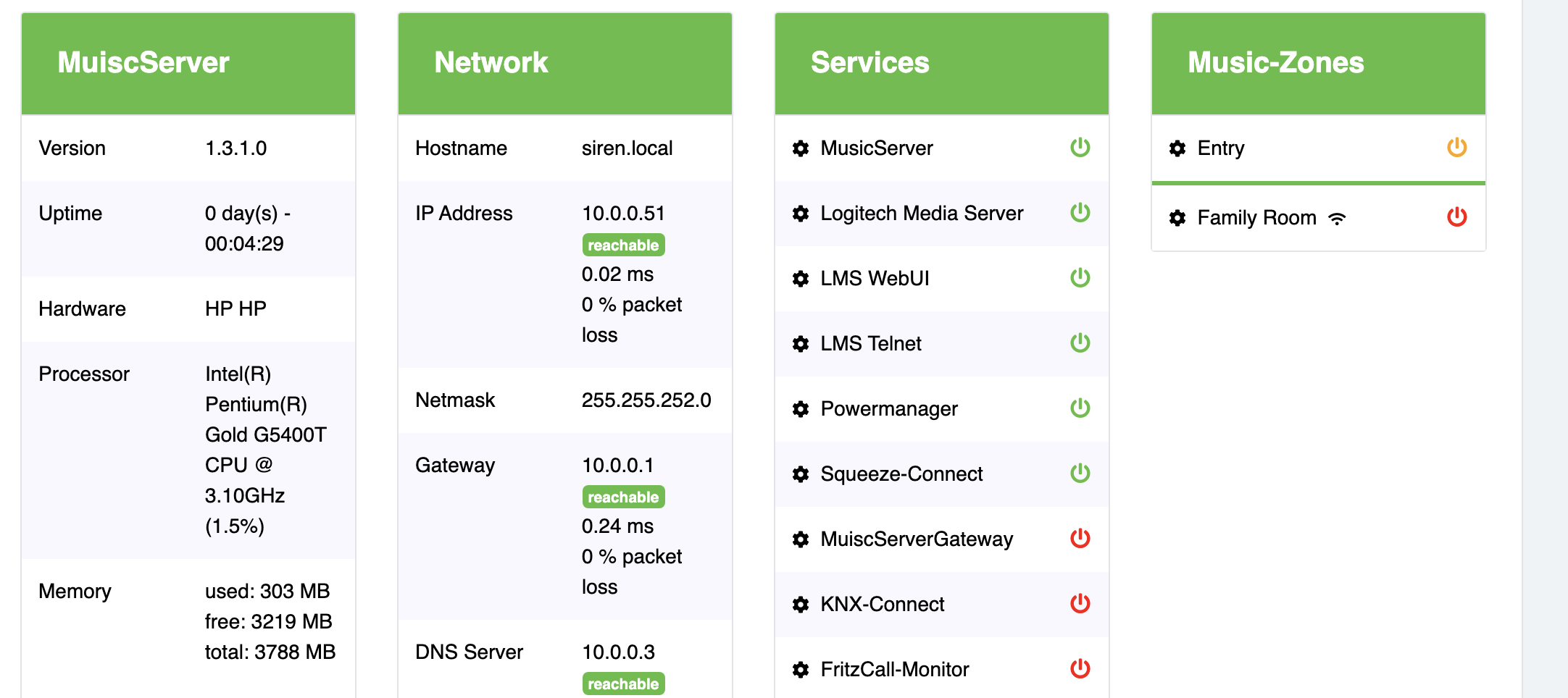

                  Ok, some progress - 2 zones now appearing after a full system reboot and adding the line-break.

                    • 7663
                    Go to /opt/music_server/sq_cfg/sq_zones.cfg and /opt/music_server/sq_cfg/sq_zones_ext.cfg
                    And put the real Numbers of Zones you have in the vars.
                    After that it should work again
                    I provide next week and update version of config check that should have a repair function.

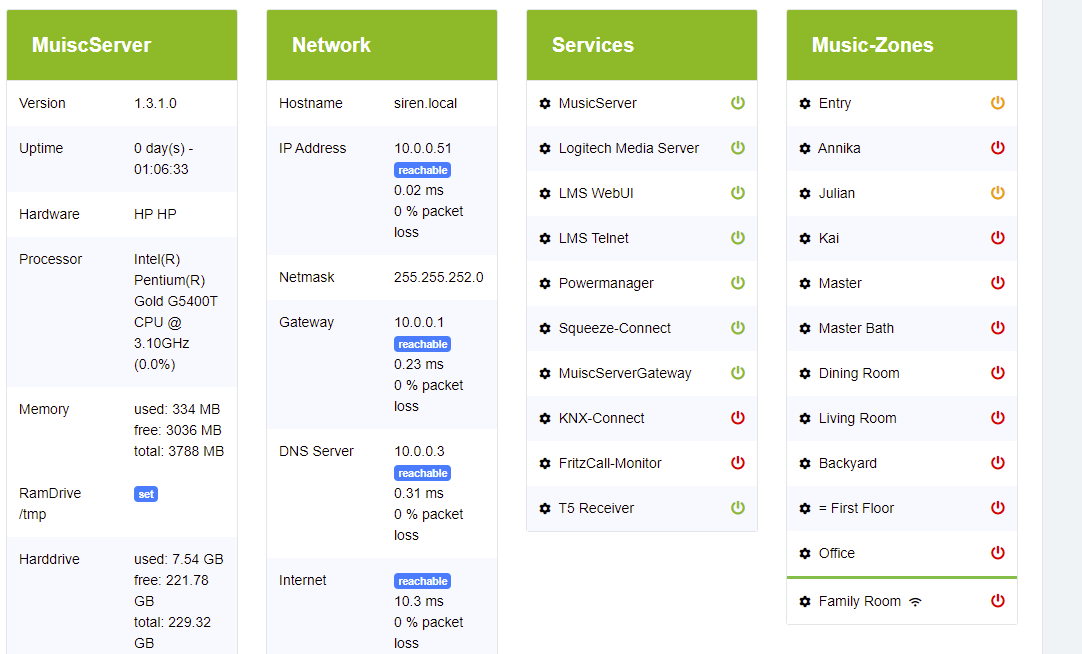

                      Thanks, that made the zones show up which is great, they are yellow or red though, so will need to figure that out. But at least getting there...
                      • tnagpal.
                        • 11.05.2019
                        • 90
                        OK, I went through them all and saved them and they are now all yellow. So now to figure out hot to get them green.
                          They don't get green... They show then play/stop, orange is standby / red = not started
