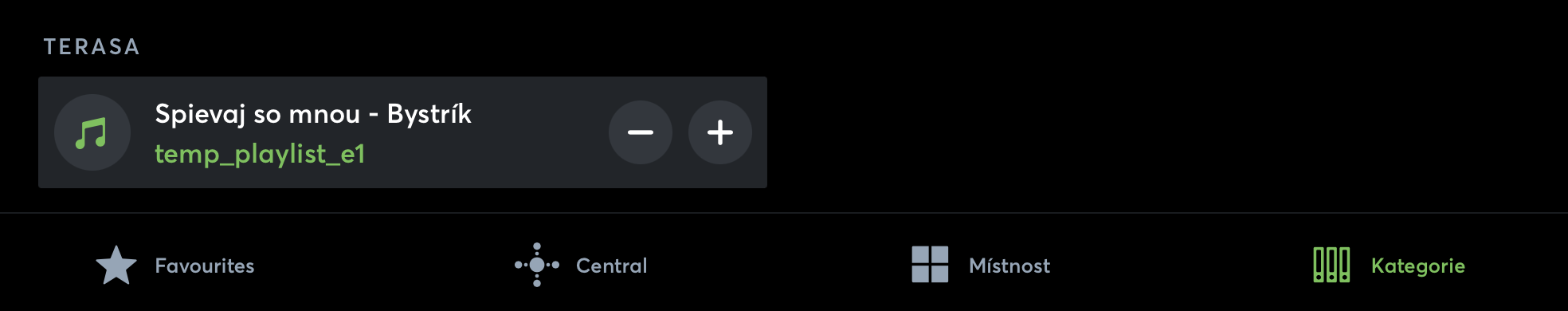

    Hello everyone, i have issue with names of playlist. When I start radio - on each internet radio i got: temp_playlist_e1 - see screenshot. Any idea how to solve this to get real data?

    It's a bug in LMS. There is not much we can do about it to fix it.
    I've noticed that this only happens for saved stations, starting the same station from the search works fine. If it works then, you can try to overwrite the saved station with the current one.

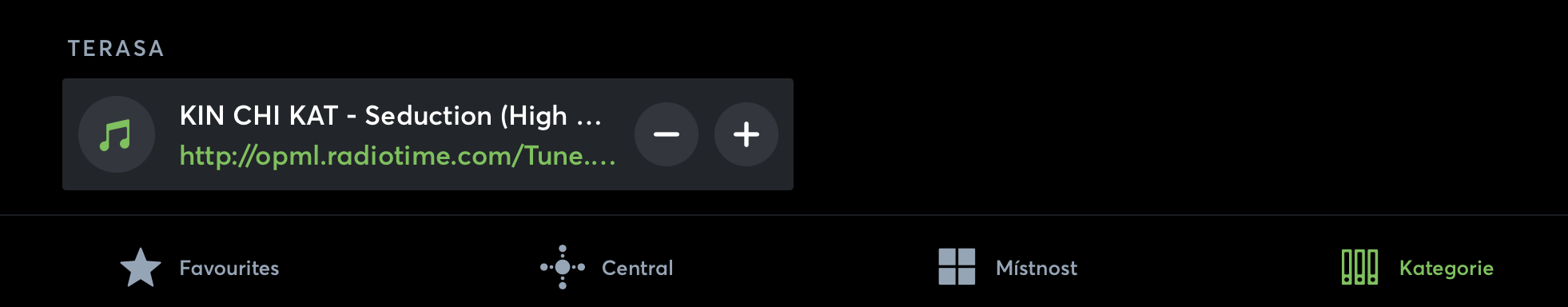

      right, but still not happy - if i pick non fav - i got this. Any way to get that info out? I would love to get just radio name and music name. Any idea how replace URL with radio name?Klicke auf die Grafik für eine vergrößerte Ansicht  Name: Screenshot 2022-07-12 at 14.52.52.png Ansichten: 0 Größe: 41,5 KB ID: 352517

        The system can only deliver the info it gets from LMS. Is that a station you got from the search or browsing or did you start a to play a radio station by URL ? Can you share the station ?

      Looks like I fix it. I removed everything from tune in, favourites - complete cleanup of LMS. Then I re-add favourites per Loxone music server and now looks like problem is gone.
