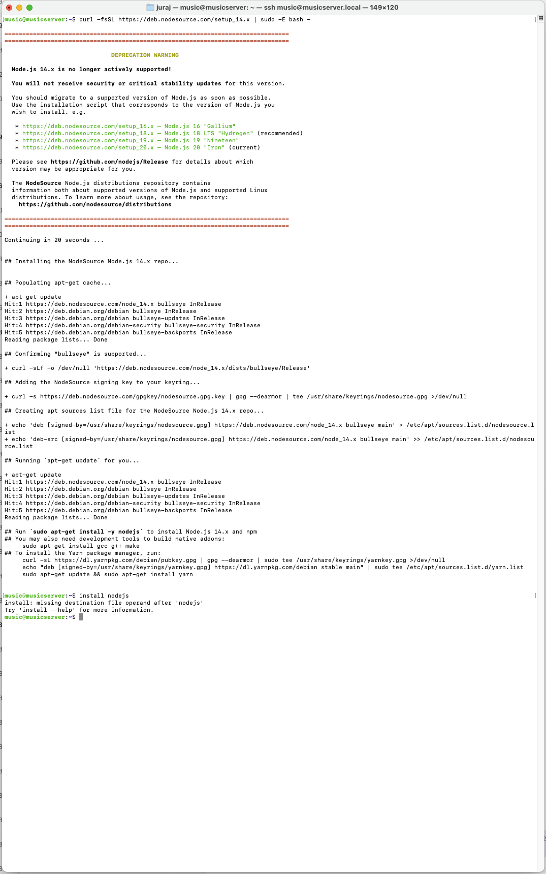

            trying to downgrade - getting this error message
            even if I try : - sudo apt-get install -y nodejs - I got another error
Name: Screenshot 2023-08-14 at 16.30.36.png
Ansichten: 220
Größe: 217,3 KB
              My mistake..,
              Missed to type apt before install
              Updated thread 18

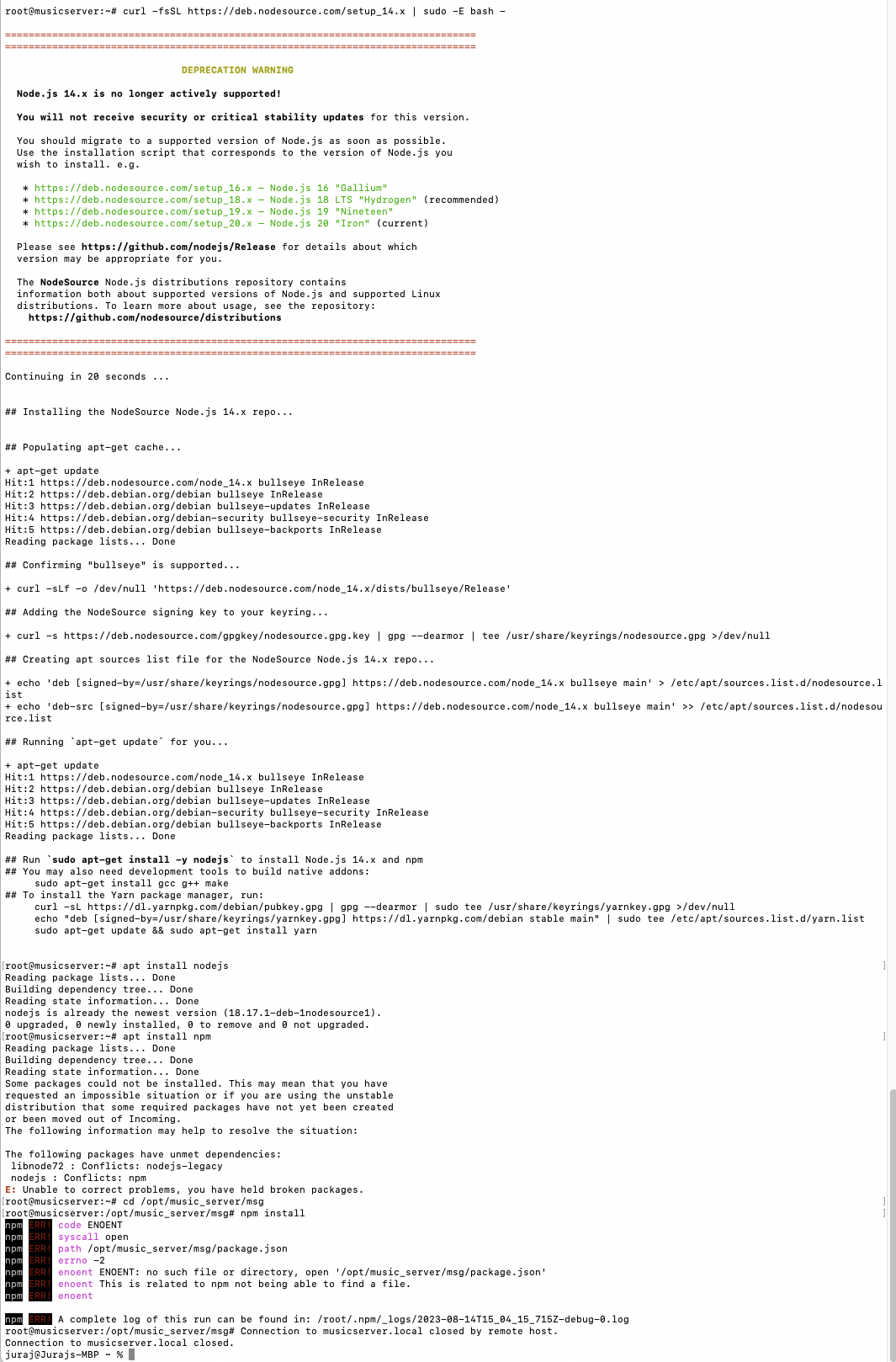

            still errors and still on same version 18.x
            • Juras
              • 10.09.2016
              • 38
              problem solved, you need to remove node js 18.x
              goo for:
              # apt-get remove -y nodejs
              # curl -sL https://deb.nodesource.com/setup_14.x | sudo -E bash -
              # apt-get install -y nodejs
              ​then server is back - tested on my setup
