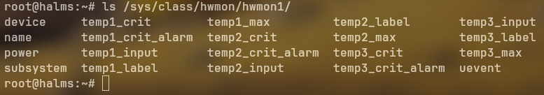

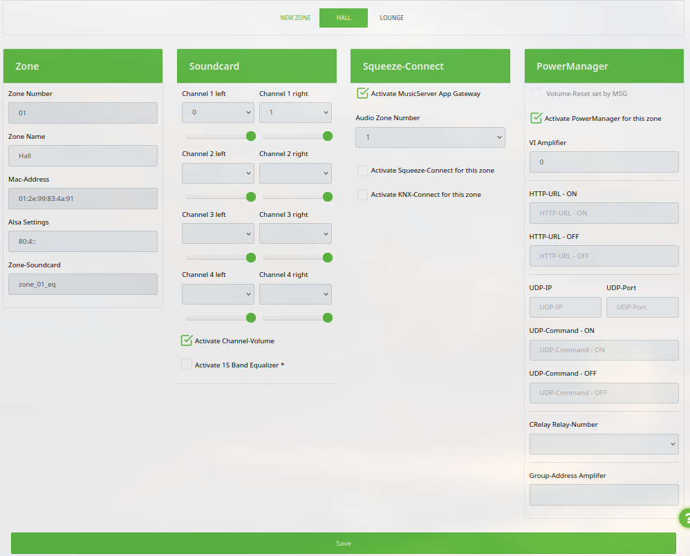

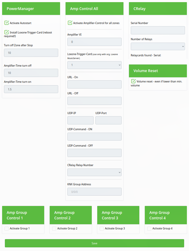

The problem I am experiencing is that the card is activated on boot and does not respond to the music server trigger responses. It has been configured in the webgui and the reboot was completed. It would appear that the required /sys/class/hwmon/hwmon1/pwm2_enable does not exist in the filesystem. Does Dietpi support hwmon pwm control?
Would a possibility be to use minimal Debian 11 install instead of DietPi?
