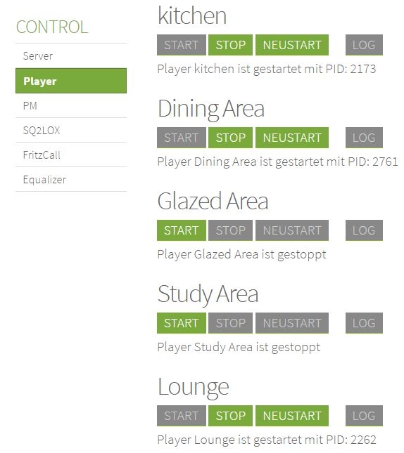

    internal players stopped at bootup

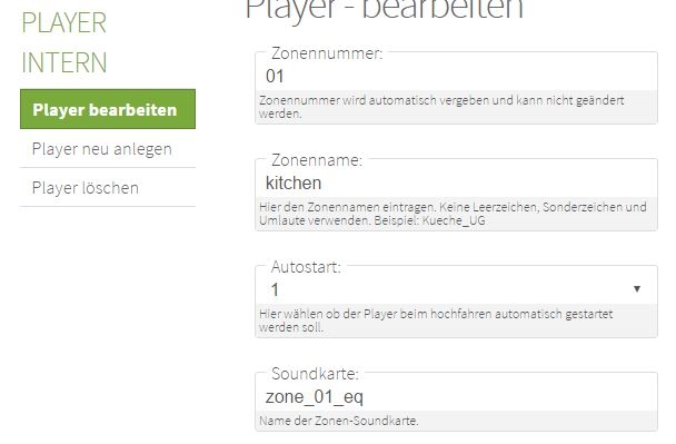

    i have 8 internal zones and some of them are stopped when the system reboots
    i dont know why some are running and some are not - is there a setting for internal zones that says start at boot?
    all the internal zones have autostart set to 1, but this doesnt seem to work for some zones

      all zones work fine, but after a reboot around 1/2 are stopped, 1/2 are started - all zones are set to autostart
      the zones start after i click on the start button in the web interface, but why dont they autostart?

        ​​​try to use zone name without a space use eg _
        For testing set all autostarts to 0
        After reboot go to terminal and type sc autostart an post a screenshot

          yes if start them by hand they all work fine
          i removed all the spaces in the zone names and they all autostart properly now
          many thanks
            • 7630
            I have written that in the Start-Thread (in german for sure) that at the moment spaces or special characters not work all over the system. In a internal version I work on thats and hopefully I can put that in one of the next versions. But it's not on highest priority.
