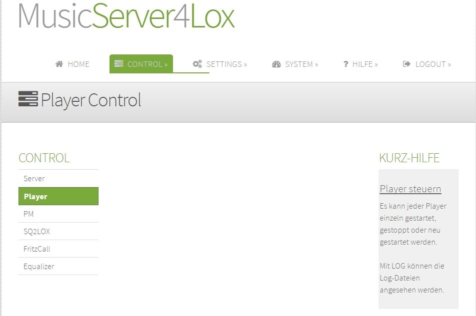

    ive just updated from 0.4 to 0.4.1 - all is working but the internal zones have disappeared from the ms4l interface, so i cant stop or start them
    they are all running as before and available in squeezeboxserver though. a similar thing happened with the last update
    the internal and external zones are all connected and working, just not there in the interface
    dell laptop, i7, 8gb ram, 512 ssd, gigabit wired ethernet
    8 internal zones, 8 external zones (logitech radios and duets)

    Download the File an extract an copy to /var/www/control/ an try again.
    If have changed the Player-Request from Player-Name to Player-Mac-Adress, hopfully this work better. Please try and feedback to me. Thanks.
    PS: If there was the same at the last update, what have you done that the players come back into the interface?

      thanks - unfortunately changing the file didnt work, neither did renaming the zones
      any other ideas?

        But you don't answer my question... What have you done the last time to get the players back?

          i formatted the hard drive and re-installed the whole system

              Please copy attached file to /var/www/include and test if the problem with the player is solved

                User ml4tlr has already done a test, it works for him.
                so hopefully I also work 4u
                i put the new file into the next update.

                  thanks - the config.php file fixed it
