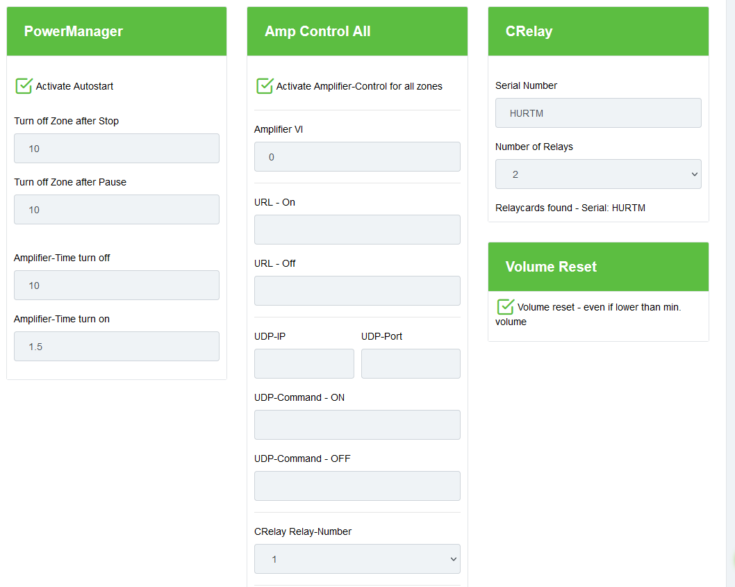

      I bought a couple different relays to try. The amplifier i am using supports both 3-5V triggers and 12V triggers.
      I plugged in this 5V relay - MS4H doesn't see it. Fine. - it isn't supported. Shame too since it would be great to not need an extra DC adapter and just use USB power to trigger it.
      Then I plugged in this 2-channel 12V relay - MS4H gets a serial number and I entered it. But it doesn't want to trigger it when I start playing music or anything.
      Not sure what I am missing here. Probably something super basic.

            • 7663
            Today I have tested the 2 relay board, I use this by my own.
            I have done all tests with the version 1.5.0.0_beta and the PowerManager 2, because this was the only option as long my family is at home.
            Works fine for Zone/All/Group commands.
