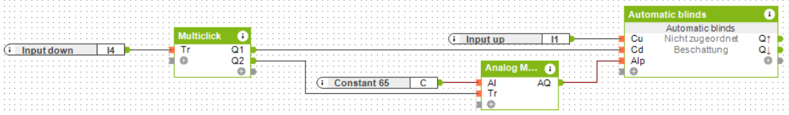

    Hi!
    I need help configuring my automatic blinds. I have an automatic blinds block, and a touch switch. I had no problems configuring up and down functions, but now I want that when a push button is double-clicked it moves the blinds to a specific position. I undertand I need to use the input AIp in the automatic blinds block. But how do I use the multi'click function block to output Q2 and set the AIp at 65% ?
    Thank you
    • 5178
    You can try it with an analog memory:
    Klicke auf die Grafik für eine vergrößerte Ansicht  Name: Jalousie65.png Ansichten: 1 Größe: 73,3 KB ID: 110746
      yeah, that works. Thank you! I still have to learn a lot about all different blocks!
