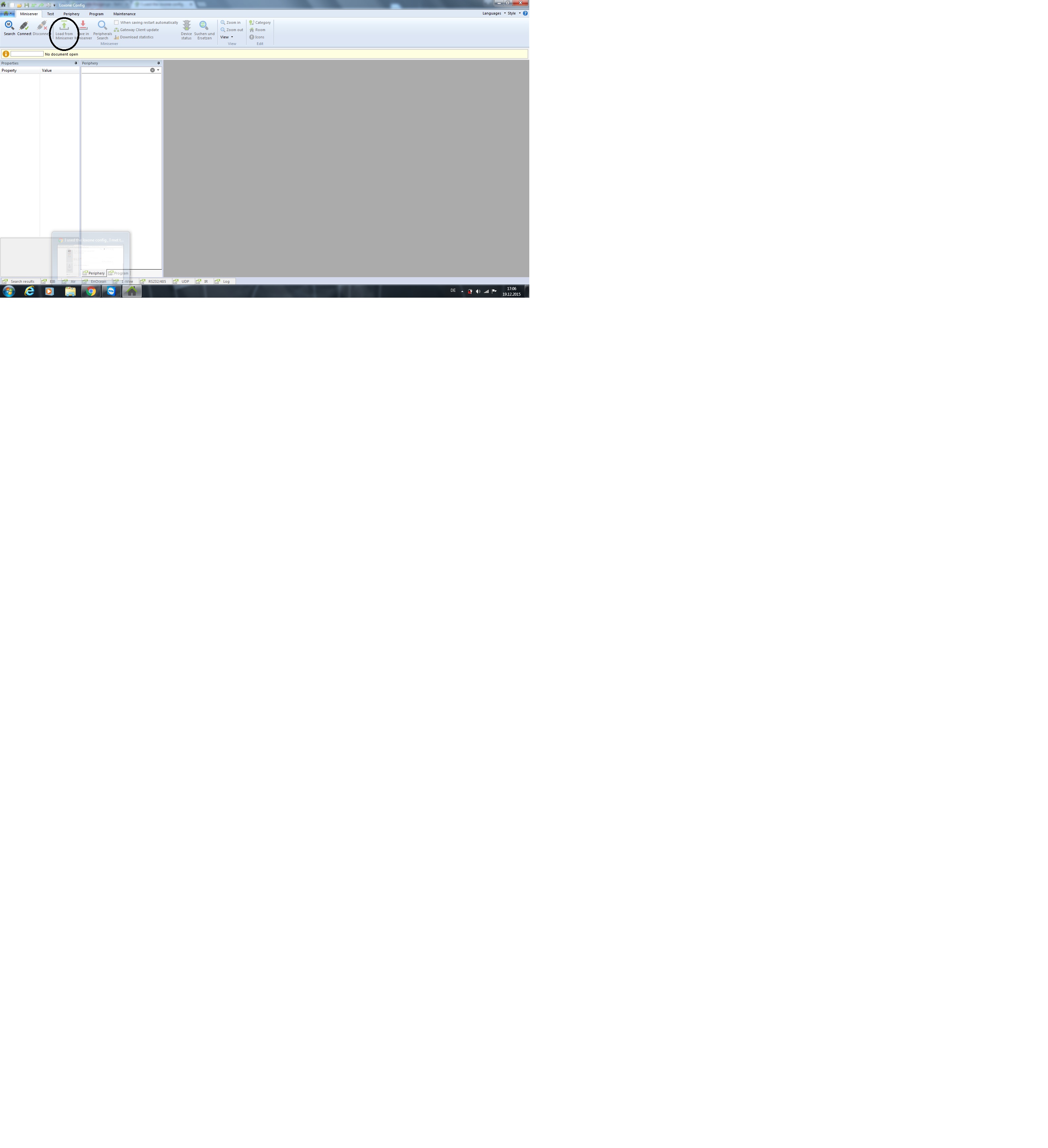

I used the loxone config , I met the message: configuration not identical !
    The Loxone config show me the messages : below picture , when I want to save the configuration to the miniserver . I have changed the serial number to the back of miniserver serial number.
    Who can explain to me ?
    Thanks lot !!

    That's because the config on the MS is not the same as you have opened in config file.

      Automation , Thanks . How can I sync the config on the MS ?

        If you are not sure what are the changes
        Download config from Miniserver

          PR-Homesystem , Thanks , I want to try . But I found that I connected the miniserver , "Load from Miniserver","Save in Miniserver " both are grey color .
            I want to factory reset the Miniserver , I connected it , and fromat SD . got the message : below picture.

              Some SD cards have a lock switch on the left side of the SD card.

                Thanks , everyone . Those issues have gone , when I save the configuration to local computer (c:\loxone)!!! before I use the share path to save .

                  If both buttons are grey, then you are not connected to the Miniserver. Connect first...
