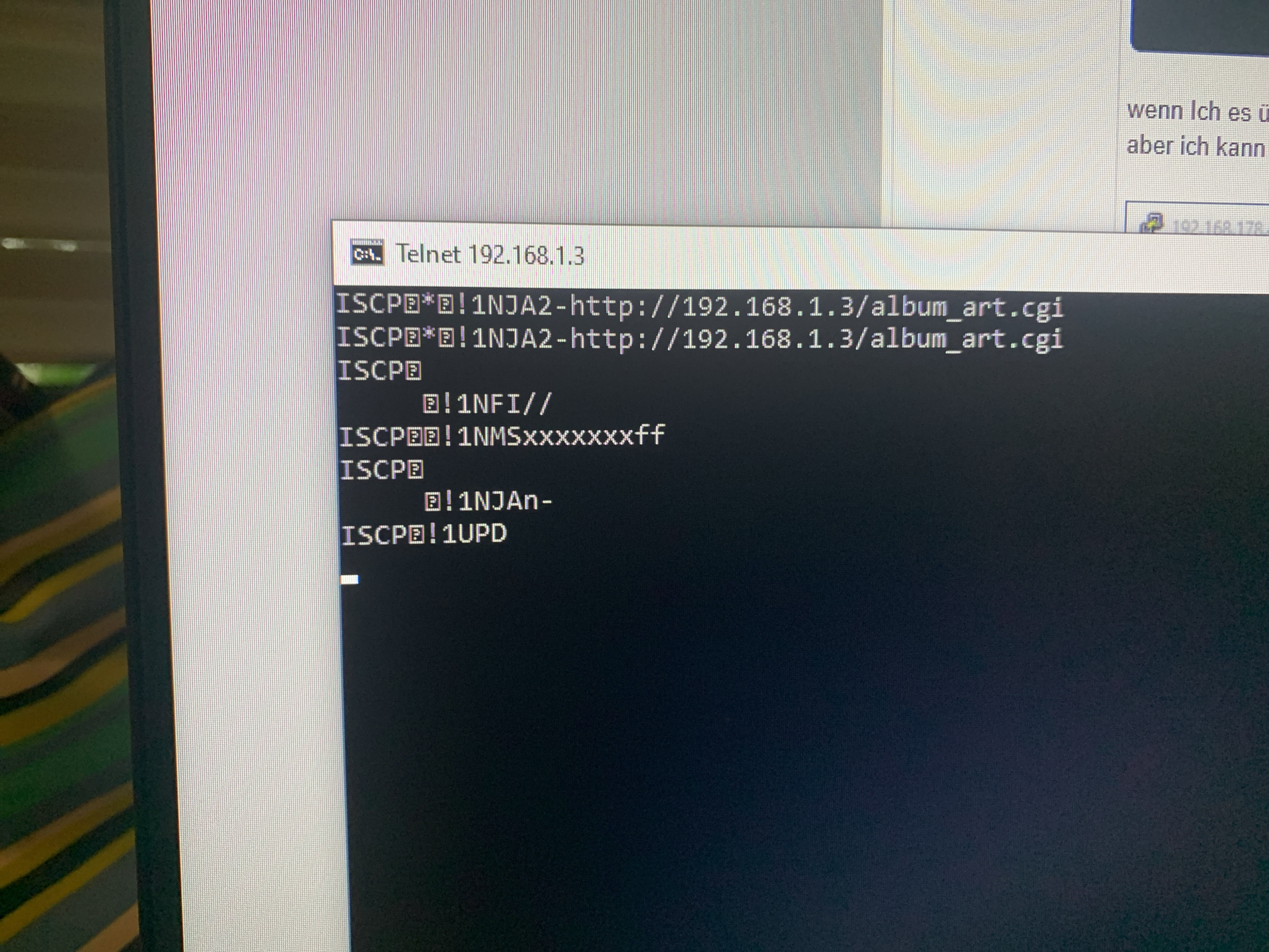

    Hat jemand von eich eine Lösung wie ich den AV Receiver in die loxone einbinde?
    kenne leider den offenen port nicht, befehle mit http, tcp, https senden, und welche befehle sind aktuell?
    Möchte Zone Zwei über die loxone ansteuern!
    Mit dem onkyo hats perfekt funktioniert

    I found this: https://www.pioneerelectronics.com/S...20-K-RS232.PDF
    Can you connect with telnet? (Putty or so)

      this is with Telnet port 60128
      no idea what this is! 🤦‍♂️
      • J V
        • 368
        Well... at least it is reacting. This means it is communicating (not for example disabled in some powersave setting).
        According to this link ( https://forum.kodi.tv/showthread.php?tid=273911 , last post), the port is 8102.
        Not sure if it solves the tcp problem, but at least if we have communication via Telnet, there is a start. I don't have a Pioneer to compare/try things so, I can just suggest basic communication things...

          These are the commands from the onkyo!
          I can now switch channels, switch on and off, turn louder but not quieter !!
          what the fu****
