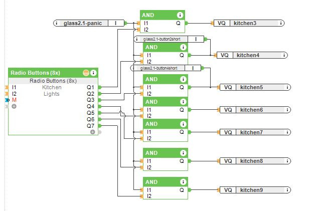

    im currently doing it using a radio button and lots of ANDs to separate digital outputs, but its messy and using a lot of config space

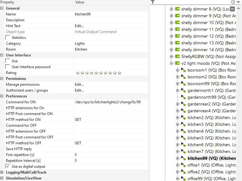

      using the web services and a VO i can ensure the buttons only turn on the chosen scene
      eg sending http://login:pass@IP/dev/sps/io/boxr...ts2/changeTo/1 sets the lighting block to scene 1, and further presses do nothing, double click turns off

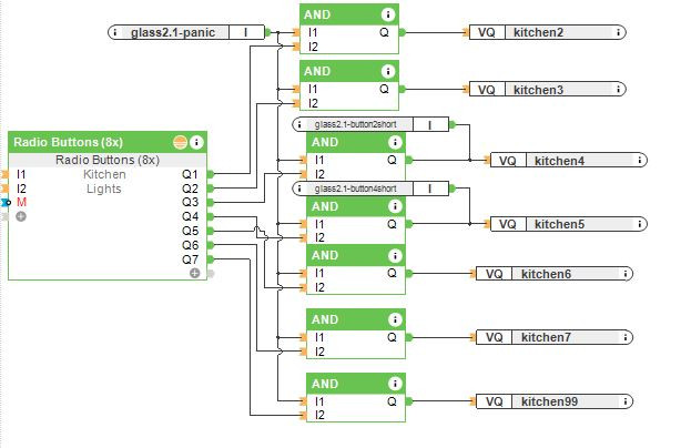

                however the complexity comes because each room has a user selectable 1st switch (favourite button) where the user can choose which of the moods are selected without having to reprogram the system
                in order to do this, i need a radio button to select the favourite scene, a load of AND blocks to link the radio block outputs and the switch input, and a virtual output for each scene and this is inelegant

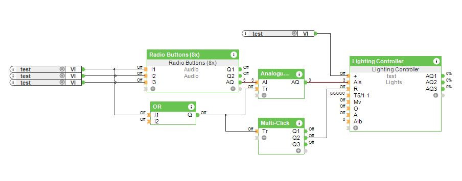

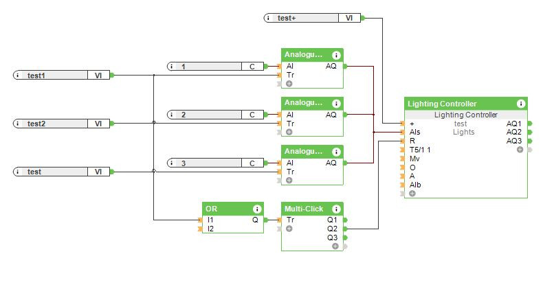

                      • duncan
                        • 363

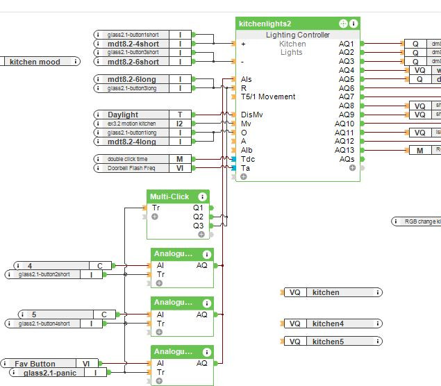

                        to answer my own question/problem, ive found a couple of similar ways to make the v2 light controller work more like the v1 using equivalents of the s1-s8 inputs, so that further presses of the same input dont cycle through the scenes, without using the web/network interface so the response is a lot quicker
                        this uses the Als input and analog memory to pass a scene value to the Als input - either using a number of analog memories per s input, else if you need a lot of these then switch inputs to the I inputs of a radio button and the inputs also triggering an analog memory to shift the radio button AQ output to the Als input of the light block
                        if necessary a multi-click block can be added between the buttons and R input to give a double-click reset function
