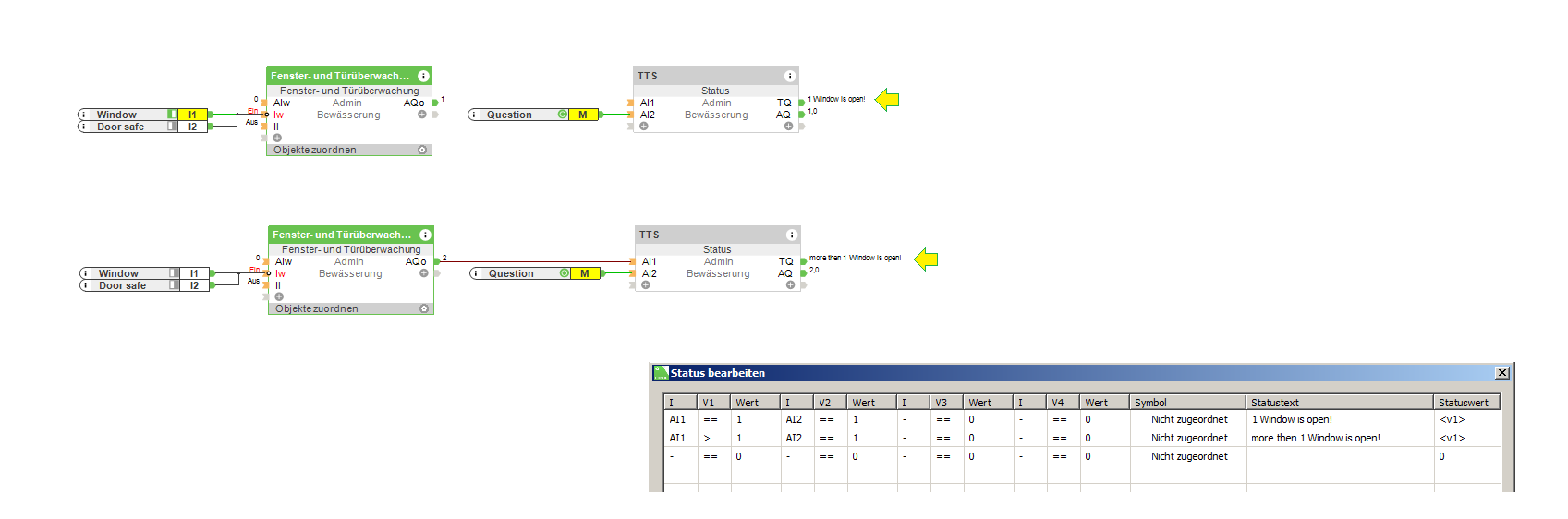

    I am looking to get my Music Server to say the status of my outside doors at 22:00 via the Status box and tts. The Music Server does work (play the status) any time something changes (a door is locked or a locked door is unlocked). However, at 22:00, the status does not change and I can not get it to just say the current status. Is there any way to send a trigger to play the status?

    maybe this will help you? ...
    L.G. Harry
