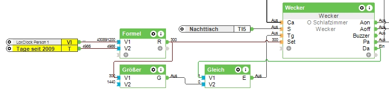

                  • Klartext
                    • 426
                    Hello, first of all thank you for the great app
                    I use it a little bit different, I use it to set the alarm clock of Loxone
                    attached my logic for this, formula is (I1-((I2+1)*86400-3600))/60
                    One question I still have, is there a way to detect if no alarm is set in Android, for me just the last value remains here
Ansichten: 576
Größe: 54,6 KB
                    • K.Clemens
                      • 92
                      The app does recognize when no alarm is set, but it does not send a specific message if this is the case.
                      In case your previous alarm is always in the past, you could use a comparison of the value with the current value.
                      Or maybe you could store the last value and see if the value has changed after the alarm went off?

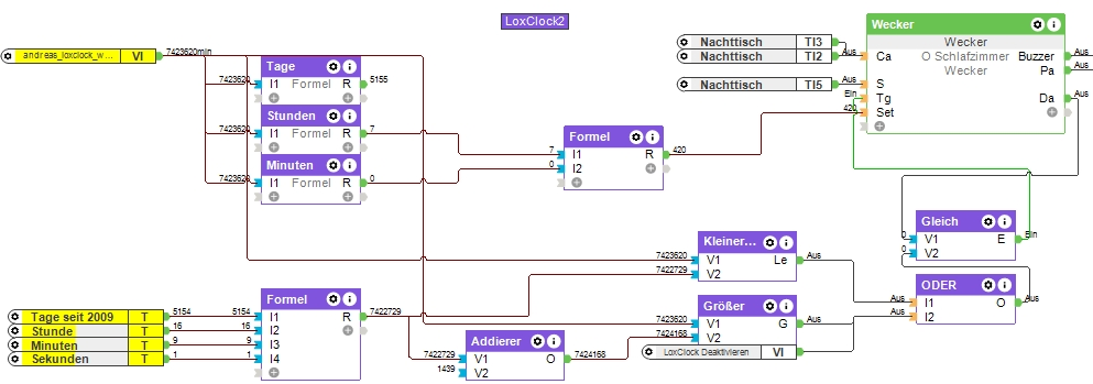

                      • Klartext
                        • 426
                        Have it now rebuilt again, now works quite fine
                        The only thing that doesn't work is if I set the alarm clock tomorrow at 6:00, but then turn it off again, it stays active in Loxone (if no other alarm clock is set)
                        I think this problem should also exist in the original example
                        I think only the app could fix this, for example by sending a high value that is not relevant for the alarm time, or send a second input
Ansichten: 569
Größe: 99,0 KB
                        • K.Clemens
                          • 92
                          #29
                          I understand the issue.
                          May I ask why you are not using the "loxclock pulse" for your alarm? This way if you remove the alarm on your mobile phone, also Loxone will not perform any action.
                          In case you want actions to be performed by Loxone prior your alarm then indeed there would be an issue I guess.
                          • Klartext
                            Klartext kommentierte
                            I drive the shading and dim the light and a few other gimmicks about 30 minutes before the alarm goes on

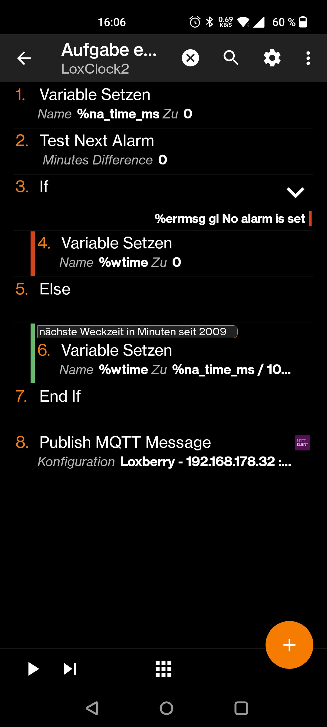

                        • Klartext
                          • 426
                          #30
                          Hello,
                          here I have an alternative version with Tasker for everyone who is interested
