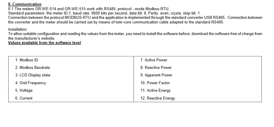

    In Our project we are using Loxone Miniserver –> RS485 Extension –> Orno OR-WE 514 Electricity counter (third party)
    I connected to the counter directly from the computer to give it the address.
    The question is how to define the command in Loxone config to get out the information. Like KWh.

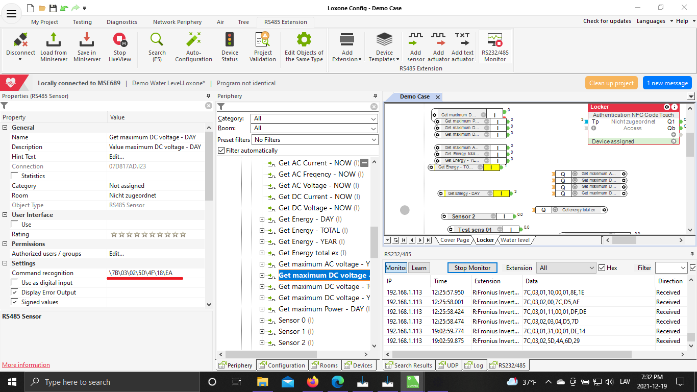

    I copied the command from Orno Manufacturer software and pasted it In RS485 sensor command.
    I have connected counters to the RS485 extension and the other end was connected to the PC via RS485 to usb adapter.
    When I send command on manufacturer software Loxone Software in RS485 monitor I can see those commands.
    So I Learned in the commands But it does not show the data I need.
    The sensor showing 0.0
    How do I set the sensor input to send this command to the Electricity counter ?
    And where in the RS485 sensor option do I insert how often it should send the commands.
    Have I correctly inserted the command, am I allowed to use slash and space when typing the commands ?

    Loxone config sensor command copied from PC software.
    Loxone config sensor command learned in from RS485 monitor

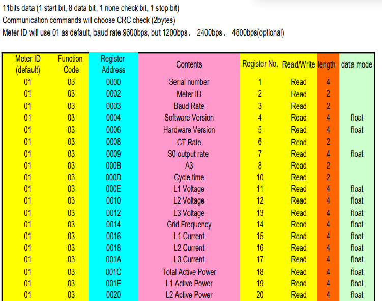

    OR-WE manual
    ORNO PC software
    OR-WE registers

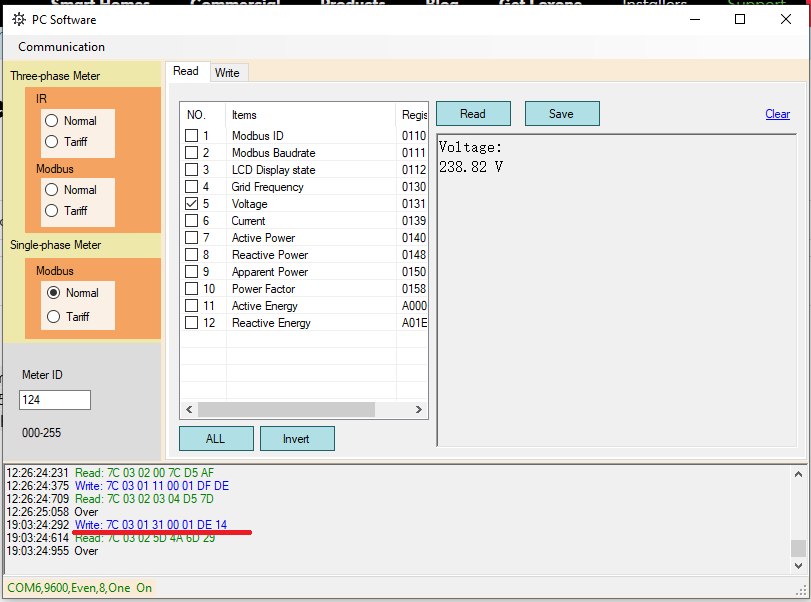

    If I refer to the following red underline in the picture, I can make out a few details -
    Klicke auf die Grafik für eine vergrößerte Ansicht  Name: Modbus.png Ansichten: 0 Größe: 50,6 KB ID: 329703
    In the Loxone Config, you should create an Actuator (not a sensor), then send the following command (Command for ON) -
    \x7C\x03\x01\x31\x00\x01\xDE\x14
    You can trigger the sending of the command by a Pulse Generator block or manually with a Virtual Input push button.
    You should receive a response that returns the Voltage. In this case the green text, 7C 03 02 5D 4A 6D 29. Where -
    7C = Decimal 124 (the meter ID)
    03 = Function code 03 (read register)
    02 = Probably defines 2 bytes length for this value polled
    5D 4A = Decimal 23882 (238.82 Volts)
    6D = Possibly part of CRC check?
    29 = Possibly part of CRC check?
    When you manually trigger the Actuator with Lox Config, monitor the RS232/485 tab and see what is returned. Look for the two values directly after 7C 03 02. Use a hex to decimal converter to check if the value is reasonable for Volts.
    https://www.binaryhexconverter.com/h...imal-converter

      It seems the Orno OR-WE 514 has Modbus protocol not only RS485 (that only defines the electrical interface but no transfere protocol)
      You should have bougth the modbus and not the RS485 extension.
      If you try to use the RS485 extension for modbus RTU then the protcol handling has to be done in software (as Tico already noted), i would recomend PicoC.
      For sure it doable but you should have C knowledge.

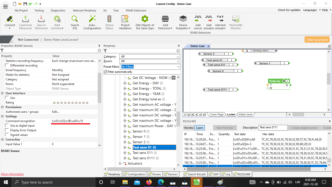

          Getting the Command Recognition correct can sometimes be a challenge in the Config. Notwithstanding, it should be possible.
          You will create a Sensor that will read the value triggered by the Actuator.
          My initial idea for the Command Recognition in the Sensor is as follows -
          \x7C\x03\x02\2\1
          This format looks for the string \x7C\x03\x02, then takes the next byte (\2) as the more significant portion of the value, followed by the next byte (\1) as the least significant portion of the value.
          Another option to try would be -
          \x7C\x03\x02\1\2
          This flips the bytes.
          If either of those options don't work, try the 'Learn' function in the Config and see what Loxone thinks... This Command Recognition won't work but will give a basis to construct another variation. The Learn function will include the value as well and because the value is changing, it won't be recognised thereafter. Other helpful information going forward is the time-frame from triggering the Actuator to seeing a response on the Sensor. This will inform how quickly you can set up the polling. It might be a sub-second timeframe to a couple of seconds. I assume each of the 80 meters has a different Meter ID?

        Big Thank you, getting somewhere!
        The only thing is problem with sending commands.
        When I send command from Manufacturer software I can see it on Monitor and learn it in as ans sensors and the voltage shows at the sensor.
        Hard to figure out why it does not send the command from the Actuator. /It sends but It does not communicate with sensor Voltage change.

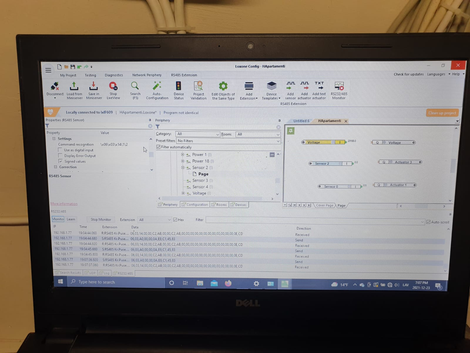

                Hi!
                Got problems reading Hex reply.
                in the picture and config they are not the same counters right now.
                in config I know the kWh was 498,.. kWh
                which is the value after 00,00
                in Adress 06 03 14 00 00 C2 AB 00 00
                i got to the point where it reads the C2 value (192) but that’s not what I need.
                wondering how to define to read whole part 00 00 C2 AB as a decimal number .
                Thank you in advance
                • Tico
                  • 31.08.2016
                  • 1035
                  Your command recognition will be -
                  x06\x03\x14\4\3\2\1
                  Where -
                  x06 = Meter ID 6
                  x03 = Function code 03 (read register)
                  x14 = defines 20 bytes length for this value polled (14hex = 20 decimal)
                  \4\3\2\1 = the next four bytes will be ingested and arranged from most significant (4) to least significant (1)
                  That will return a decimal value of 49835. You will need a formula block to divide this value by 100.
                  Result = 498.35 kWh for the Total value of the Meter.

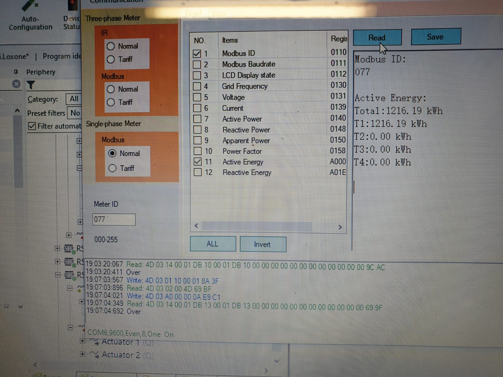

                  In the PC screenshot example, the same method is used for the command recognition -
                  Klicke auf die Grafik für eine vergrößerte Ansicht  Name: PC Meter.png Ansichten: 0 Größe: 1,80 MB ID: 330218
                  Command Recognition = \x4D\x03\x14\4\3\2\1
                  Where -
                  x4D = Meter ID 77
                  \4\3\2\1 = the next four bytes arranged from most significant (4) to least significant (1)
                  That will return a value of Decimal 121619. Divided by 100 = 1216.19 kWh for Total value. The values returned are repeated again (00 01 DB 13), according with the T1 value in the screenshot. The last two values (69 9F) will be the CRC check. The values between represent T2, T3 and T4.
