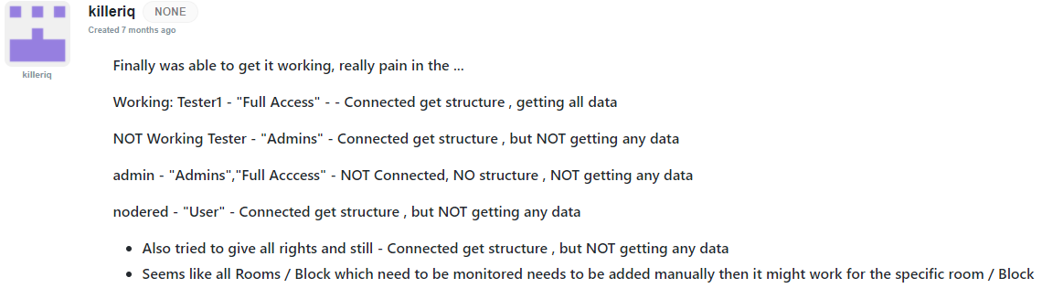

        Seems like the issue is down to the new Loxone user permissions on latest versions of config
        and if permissions are not set correctly in Loxone, causes the NodeRED to constantly crash
        I found this link:
        https://githubmemory.com/repo/codmpm...sues/58?page=4
