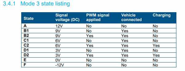

    I just installed an Alfen Wallbox.
    I'm able to read most of the Modbus values using Modbus TCP. However there is also a string value. This gives the state of Wallbox and car.
    Klicke auf die Grafik für eine vergrößerte Ansicht  Name: AlfenModbusState.jpg Ansichten: 0 Größe: 38,2 KB ID: 343716
    I have no idea if it's possible to read this string value.

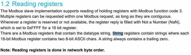

    Klicke auf die Grafik für eine vergrößerte Ansicht  Name: AlfenModbusStateRegisters.jpg Ansichten: 0 Größe: 61,9 KB ID: 343717
    Some more information concerning the string datatype

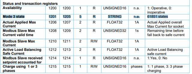

    Klicke auf die Grafik für eine vergrößerte Ansicht  Name: AlfenModbusReadRegisters.jpg Ansichten: 0 Größe: 44,1 KB ID: 343718
    Will it be possible to read this string value?

        I think the eaisest way would be to convert the values presented by the "Mode 3 State Listing" to decimal. It appears there are only 9 states possible. The following two sites are helpful -
        https://www.binaryhexconverter.com/a...nary-converter
        https://www.binaryhexconverter.com/b...imal-converter
        Example: State = A
        A in binary is 01000001. Loxone should read this binary value and present the decimal value for 01000001. That decimal value is 65.
        In a Status block, have the Modbus sensor to AI1. If AI1=65, Status Text = A
        Example: State = B1
        B1
        in binary is 01000010 00110001. Loxone should read this binary value and present the decimal value, 16945.
        On the second line of the Status Block, If AI1=16945, Status Text = B1
        Example: State = B2
        B2 in binary is 01000010 00110010. Loxone should read this binary value and present the decimal value, 16946
        On the third line of the State Block, If AI1=16946, Status Text = B2
        etc, etc, etc.
        edit: On re-reading the "Reading Registers" screenshot, the byte order might be reversed. So the example B2 -
        01000010 00110010 becomes 00110010 01000010
        This is decimal 12866.
        Whichever byte order is used, it should be consistent across the 9 states.

            the mode 3 state can be read out with the following settings:

                FlorianZ I think value E should be 17664 and not 17644
                  Good morning! Thanks for this, great idea.
                  Just to understand, how did you arrive at 16640/17644/17664/17920 for A/E/F? Should this not just be 65/69/70?

                    For just the character 'A', you would expect 65. Likewise character 'E' would be 69 etc. However, the string is 2 bytes, with the second byte having a 0 as padding.
                    ASCII text character A = binary 01000001 = decimal 65
                    Second byte padding = binary 00000000 = decimal 0
                    Both 'characters' sequentially = 0100000100000000
                    The binary string 0100000100000000 = 16640 decimal
