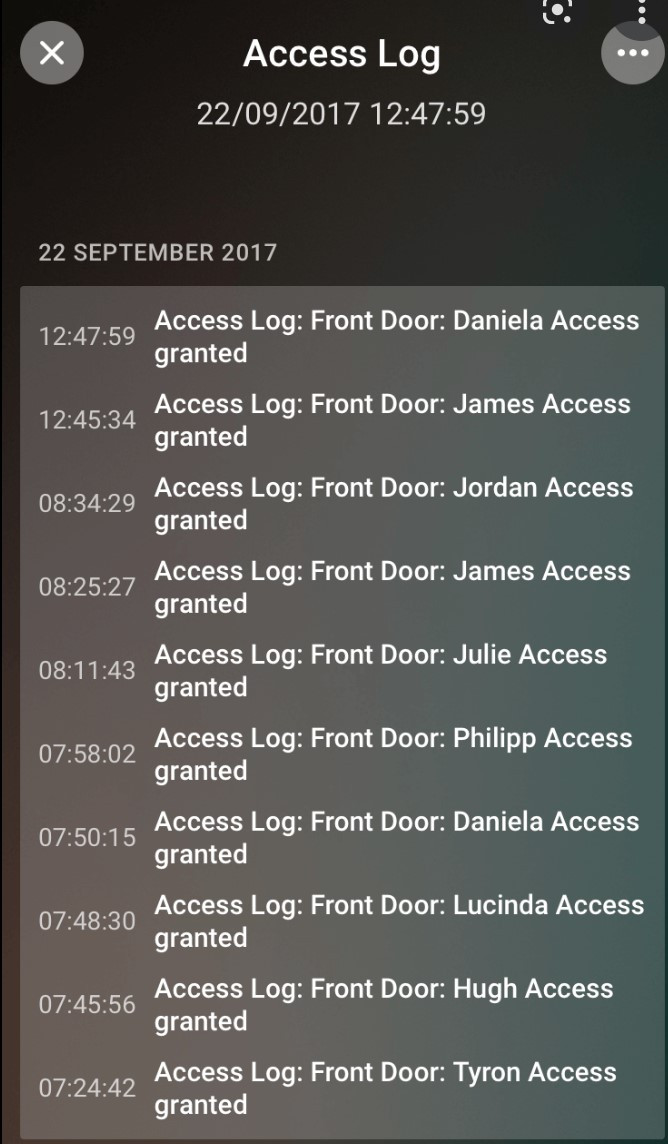

    Hello,
    I have a door contact on my front door and I would like to create a kind of log file as shown in the picture bellow so that I can see in the Loxone app when the door has been opened.
    For the moment I activated the statistics for my door contact and I have the data in a graph but I would like to have it in text format as on the picture.
    Anybody an idea how I could do this?

    That is exactly what I'm searching, too.

      Meanwhile I found the solution, you need to add a tracker under messages in the miniserver.
      Learn how to track and log bits of information in the user interface.

        Thank you, that is what I was searching for.
