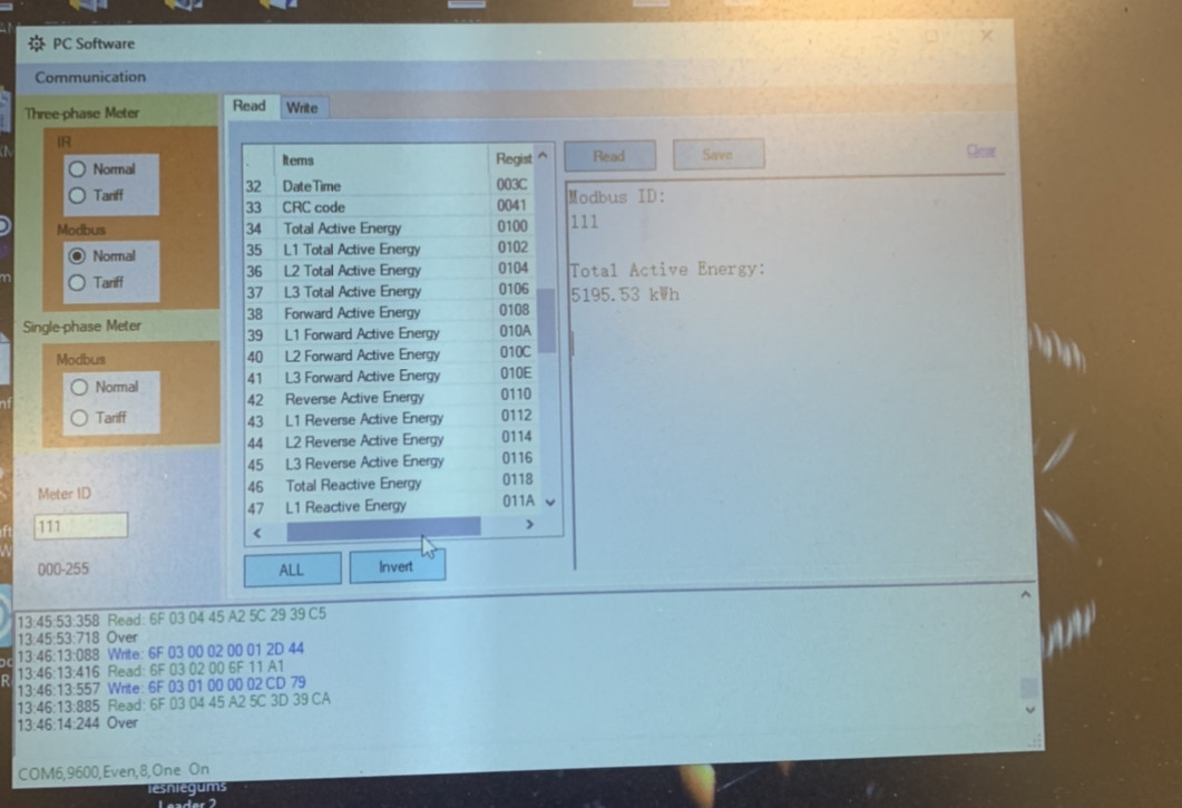

    I have a problem reading data from an ORNO OR-WE 517 3-phase meter.
    How should I define the Loxone command to make it read kWh from the meter.
    On request 6F - Meter ID
    and 0100 - Register to read Kwh.
    In response there is no Kwh if I convert Hex to dec.
    How should I convert it to get Kwh?
