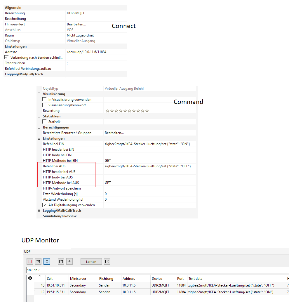

      • buki
        • 17.05.2017
        • 84
        Not sure why, but the (red marked) off-parts are missing in your screen. Below my configuration. This works for me, at least.
        I tried to create some combinations with <v> and state/text like your example, this wasn't working for me neither. I couldn't see anything in the UDP monitor when I use <v>.

        good luck.​

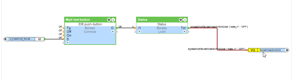

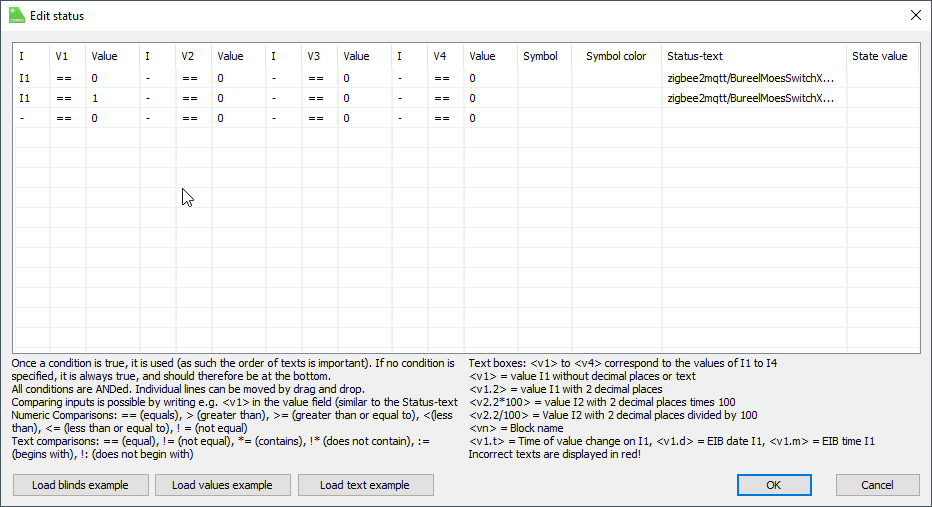

            Been debugging a bit. So if I directly set the JSON in the command (sort of like "hard coding" it there), then it's going to be escaped. Also, when using the "Test Command" menu (which I've been doing to actually test it...) does the same, the message body gets escaped. However, when I'm for example adding a push button -> status block -> Virtual Output, where the status block sets the same exact output
            { "color": { "r": 100, "g": 150, "b": 200 } }
            , it actually does NOT get escaped. I'm pretty sure this is a Loxone bug actually, which have been introduced between your version and mine (I'm on latest). Where should this be reported?

          • jensmh
            • 99
            I just configured my first Miniserver -> MQTT connection. To avoid the problem with the escaping, I used the "text-generator" block. Works like a charm.
            Simply put the desired text in the first parameter, don't use anything else.
