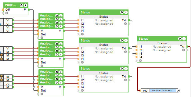

    How to limit the frequency of sending data (JSON) through a virtual output in Loxone Config to ensure that data is sent no more frequently than once every 30 seconds, instead of every time the value changes as it currently does?
    I am assembling a JSON using STATUS blocks tree and sending it directly to a virtual output. However, the data is being sent too frequently. I tried using a TEXT_GENERATOR block before the virtual output and triggering it with a pulse every 30 seconds. But when the trigger output value is low, it lacks values, and the virtual output interprets this as a change and attempts to send the empty value.

    if you cant reduce the sampling rate directly from your virtual inputs, one option is to connect them to your status blocks via an analog memory block, and put a pulse every 30 mins onto the set input - this will transfer the input value to the output value every 30 mins

          I think duncan was referring to the raw numeric value coming from the virtual inputs and memory flags. An analogue memory needs to be placed on every input (x12?). The analogue memory will only retain numeric values. It won’t retain the unit appended to each value.
          You can re-create the unit in the status-text field ( eg. <v1.3>rpm )
          It’s probably simpler to execute the approach at post #3.

              However, the solution you proposed here, with an analog memory block on each input of the status block, solves the problem but requires many monotonous steps.
              It would be much more efficient if everything could be resolved by the last status block without analog memory...
              Thank you so much for the tip. I would be even more grateful if you could help finalize the solution with the last status block.

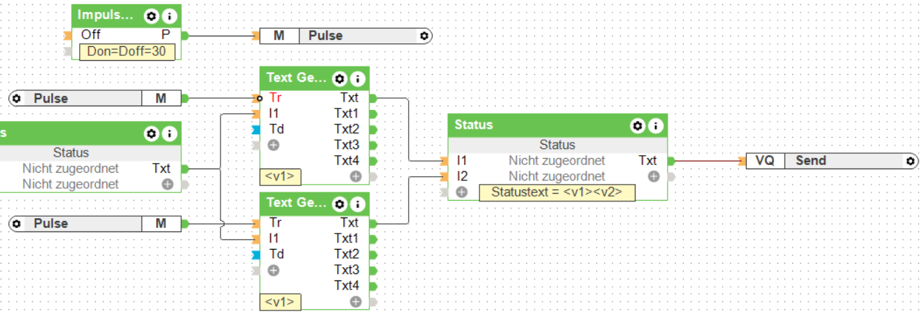

                      • 5178
                      ...maybe in this way​
Ansichten: 445
Größe: 147,5 KB
                      • Tico
                        • 31.08.2016
                        • 1035
                        Very nice romildo. Is it your view that the Status block behaviour has changed over recent upgrades?
                          no, I do not think so, but I don't know.
