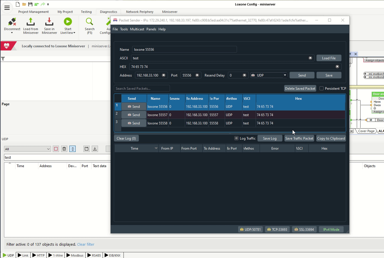

    I've encountered a baffling issue with my Loxone Miniserver that I hope some of you might shed light on. For years, I've had a virtual input on the miniserver configured to listen to port 55556 for UDP messages. This setup has been working flawlessly until recently.
    Yesterday, I noticed that no messages were being received on this specific port. Initially, I suspected the device sending the messages might be malfunctioning, but this theory was quickly disproven when attempts to send messages from a different device to port 55556 also failed to show up in the UDP monitoring of the miniserver. As soon as I changed the listening port to 55557, everything started working again as if nothing had ever happened.
    I have not made any changes to the configuration of the miniserver or the router recently (regarding ports), which makes this behavior even more perplexing. No reboots have changed the situation. Messages sent to 55556 do not show up in the UDP monitoring of the miniserver.

      Encountered this phenomenon again: port 55557 (which I had chosen last time) has stopped receiving data via UDP. Here is what it looks like (picture below). Interestingly, last time, port 55556 stopped working, and it only started to receive data the day after I switched to port 55557.

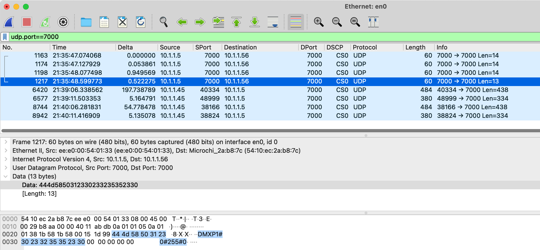

            In regards to the post from Christian Fenzl : I'm not sure how the Loxone OS / kernel is operating, but in Linux it's not unusual that a program needs to allocate a local port from the OS first. I found an example in Java: https://stackoverflow.com/questions/...ng-udp-packets . Here the port (called socket) is allocated by datagramSocket = new DatagramSocket(); and in this example an unused local port is choosen randomly by the OS. In my opinion the OS is pointing to that process via socket, so whenever a packet is received on that port it will be forwarded to that process. With UDP typically the local process would send a request and may expect a response from the remote side.
            I had a look on my MS and I've seen that I have a UDP input on port 7000 and at the same time I'm also using this port as an output for an ethernet to DMX converter. When I receive a packet from the remote system it is using a random remote port to send the data and the destination port on the Loxone MS on port 7000 (last four packets in the example). I would have expected that a UDP output connector on the MS would do the same, but Loxone is using the same port 7000 as the local port:
            Klicke auf die Grafik für eine vergrößerte Ansicht  Name: Bildschirmfoto 2024-03-07 um 08.27.16.png Ansichten: 0 Größe: 297,2 KB ID: 425810
            Technically it's working on my MS so far, but this shows that Loxone OS is not similar to Linux and my assumption that a local port / socket needs be allocated first, is wrong.
            I would recommend to open a ticket with Loxone to solve the problem. It may be worth to choose a complete different port, e.g. 7000.
