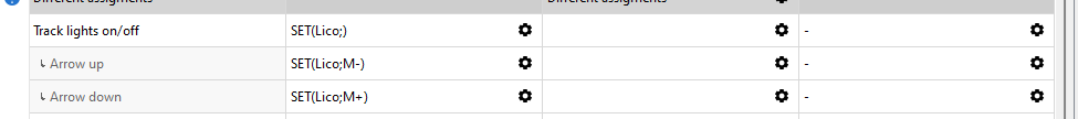

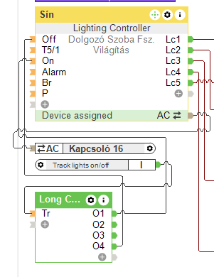

    Hello!
    I'm trying to figure out how to do the following: (simplified version) I have track lights controlled by a lighting controller. I have Touch Pure Flexes on the wall with a button called "track lights".
    The goal is to:
    1. Turn on the lights (select mood 99) by simply pressing the button
    2. Change moods with the up/down arrows
    3. Turn off the lights by long pressing (let's say more than 2 seconds) the button
    1. and 2. works, but I can't seem to make the 3rd point work. The Long Click simply always triggers the O1 output doesn't matter how long I actually press the button.
    Is there a way to do this? Attached images of my current setup.
    Cheers!

      Actually, yes. I don't have a T5 switch though, so I'm not sure it helps, but with Touch Pure Flex there's an option called "Button behaviour" which by default is set to "pulse". I changed it to "OnOff" and now it recognizes long clicks as well as multi clicks.
      The closest I have to a T5 switch is a Touch Surface, but that doesn't seem to have this button behaviour option, however, it recognizes long clicks by default.

        Ah yes that's helped for the T5! Thank you!
        Exactly like you said, it was in the parameters and was set to 'Pulse' so I changed to 'OnOff' and it's now recognising long clicks.
        I have a Nano relay & a t5 for Nano, so the parameters were inside of the Nano itself and not inside the Touch's (I think that's why I missed it)!
