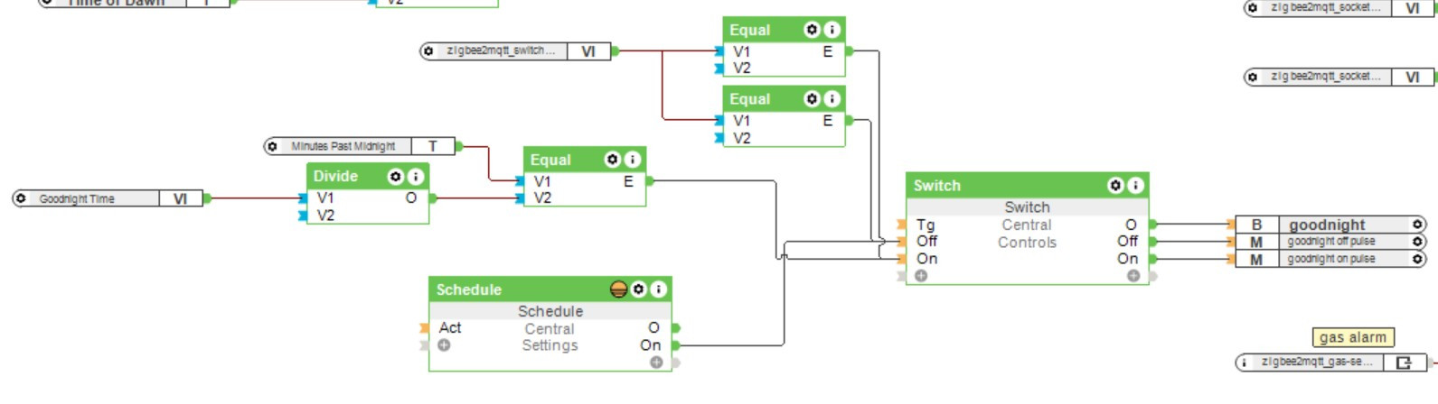

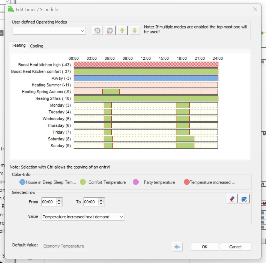

    the key here is operating modes - you can add these to each heating block at the top of the list and set a suitable temperature when that mode is active
    when you create an operating mode, you have to click on it and select "add output reference" at the top and drop it to your config - you can then use a real or virtual switch to activate that mode
    so for instance a holiday mode is added to all the IRCs, with the temperature set at setback/eco or frost protection for the whole of the 24hr period - whenever it is active it will override the IRC normal shedule
    if you want the mode to turn off after a set time, you can use the virtual / real switch to activate a stairwell lights switch which has a countdown timer, and use the output of this to activate the mood
    similarly you can create the same for a "goodnight" function - mine has a scheduler to activate the goodnight operating mode, but has a button to manually toggle it on/off

        ive added a loxconfig with exemples of everything - you can open this in config as well as your own file and copy/paste some bits or copy bits you want into your own
        work on a copy of your existing config so you have a backup!

          you can use operating mode in a way as you want to: push one button --> operating mode is active/inactive --> reaction on all configured components e.g. all room controlers go on ECO mode.
