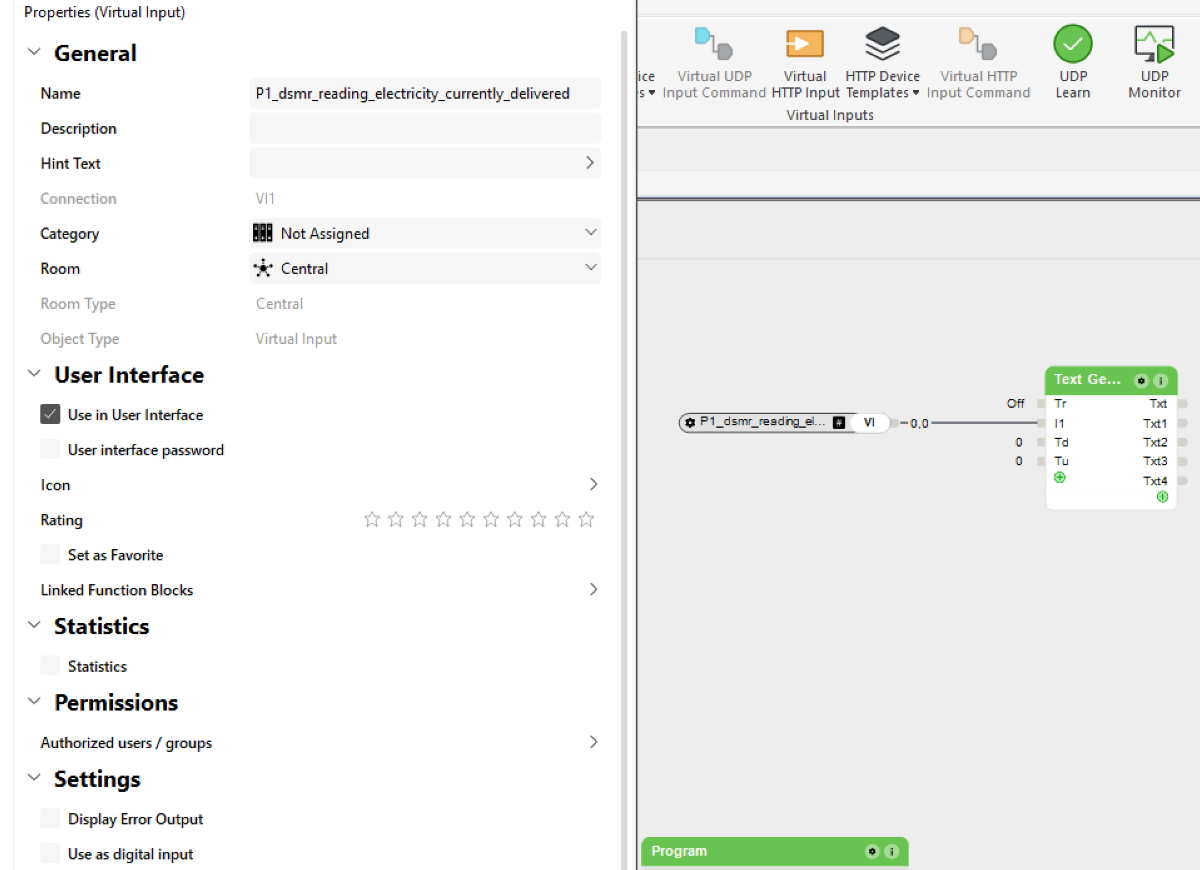

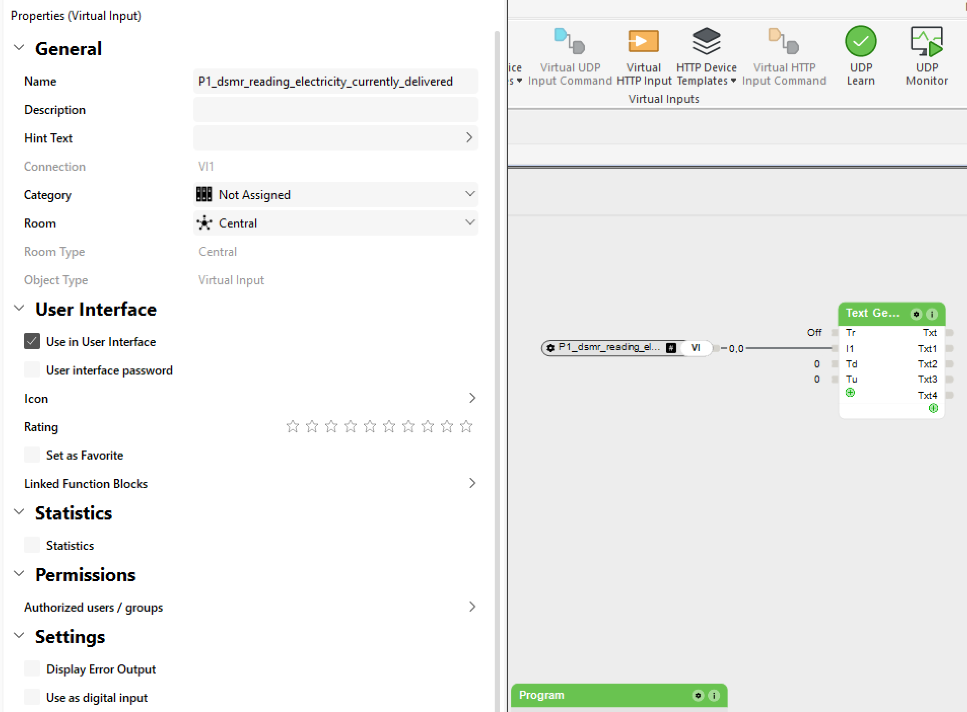

    Hi, I'm obviously missing something simple, but don't see what.
    I've setup Loxberry (3.x) with 'all green' health check's. the MQTT server has a subscription to a power reader. I see 'Miniserver Virtual Input's with the topic's I need and correct values. However I can't integrate this to the miniserver.
    As far as I understand it is as simple as creating new virtual inputs in the config, disable the 'digital input' and ensure the name is equal to the virtual input name mentioned in loxberry. However that doesn't work. What do I miss?
    in loxberry:

    in loxone config:

    Replying on my own topic. I had to change the loxberry user in loxone config to a full-access user to make it work.
