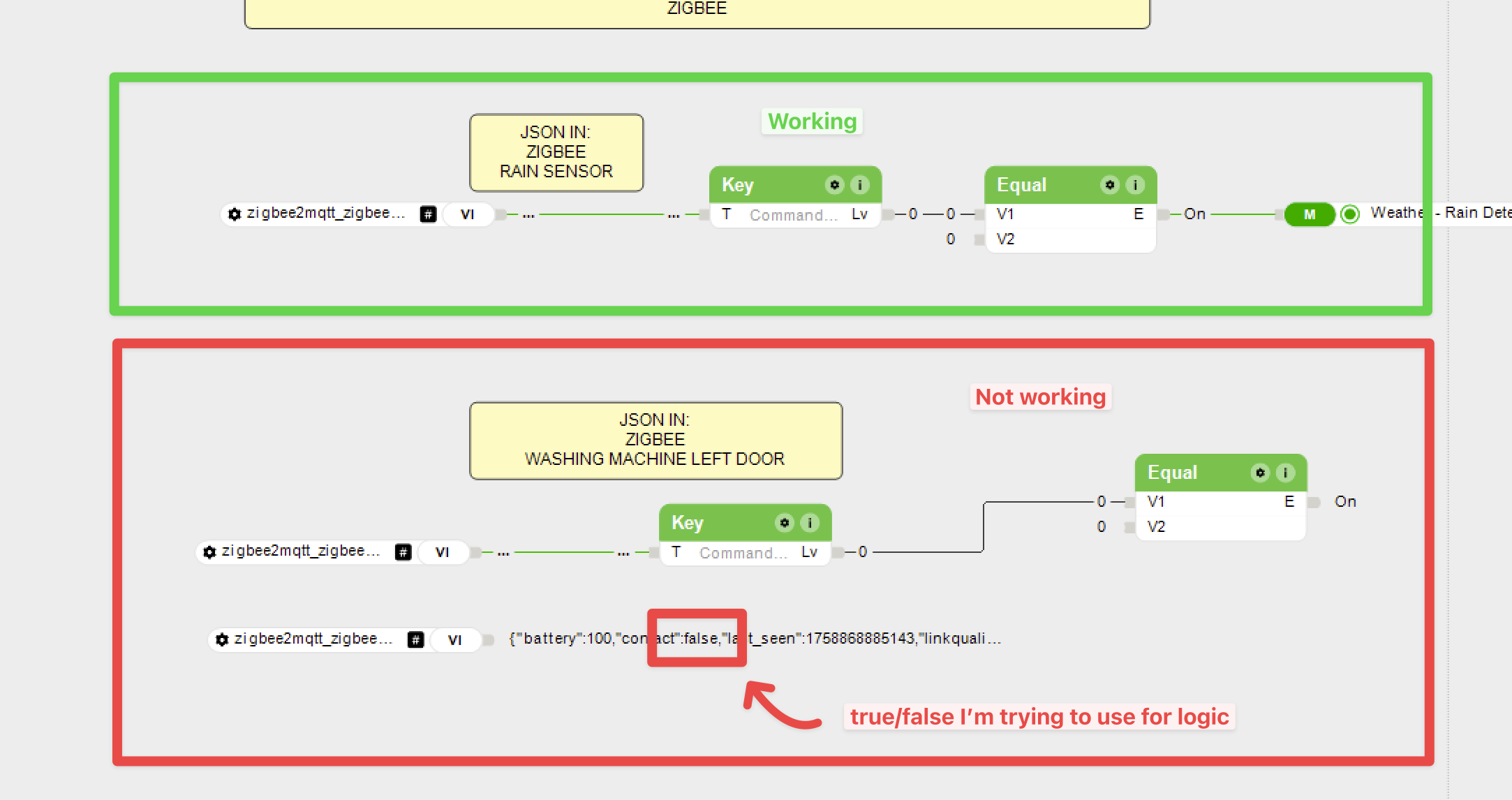

    Hey Guys
    I'm looking for advice on how to take a JSON input from MQTT and convert it to something I can use. Normally, my devices come with a numeric value, so that is no problem; however, the device below returns a 'true/false' result.
    2 Questions:
    1. How can a JSON MQTT input be used as a http virtual input. What is the url example back to the miniserver?
Ansichten: 68
Größe: 31,5 KB
    2. Does anyone have an example of using a text input to some logic?
    Normally, I would use the Command Recognition block but this does not work for text for me.
Ansichten: 112
Größe: 90,6 KB
    As always TIA
  • Andsor
    • 08.07.2025
    • 2
    For true/false results from MQTT, you can parse the JSON via a Virtual HTTP Input and then use a Virtual Output + Logic block to convert it into 0/1. Example URL: solitaire bliss
    http://user:pass@miniserver/ip/dev/sps/io/InputName/1
    (or 0 if false).
    For handling text input, try using Regex in the Command Recognition block, or run it through an intermediate script (Node-RED, Python, etc.) to map text into numeric values and send them back to the Miniserver.
