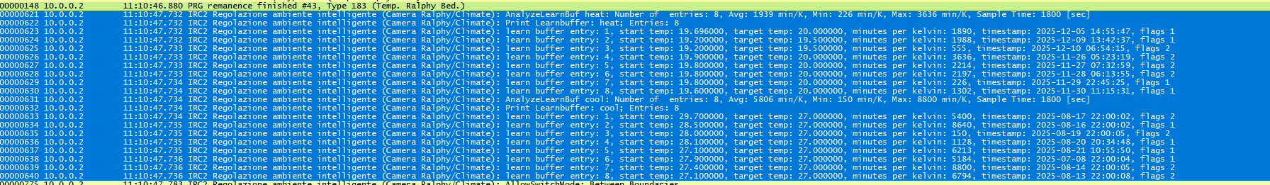

    I am trying to reset the learn buffer of Intelligent Room Control (IRC2) to start a new learning period of temperature and adjust it to actual condition of my room.
    I read a lot and look on the WEB and finally it seems that using the trigger Rtd input in IRC2 should work. It is not, the learn buffer remains unchanged as I read in Loxone Monitor (see screeshot below).
    1) any idea how to do? what is the logic behind it?
    2) any idea how to read\write this buffer from Programming Block and what means each entry?
