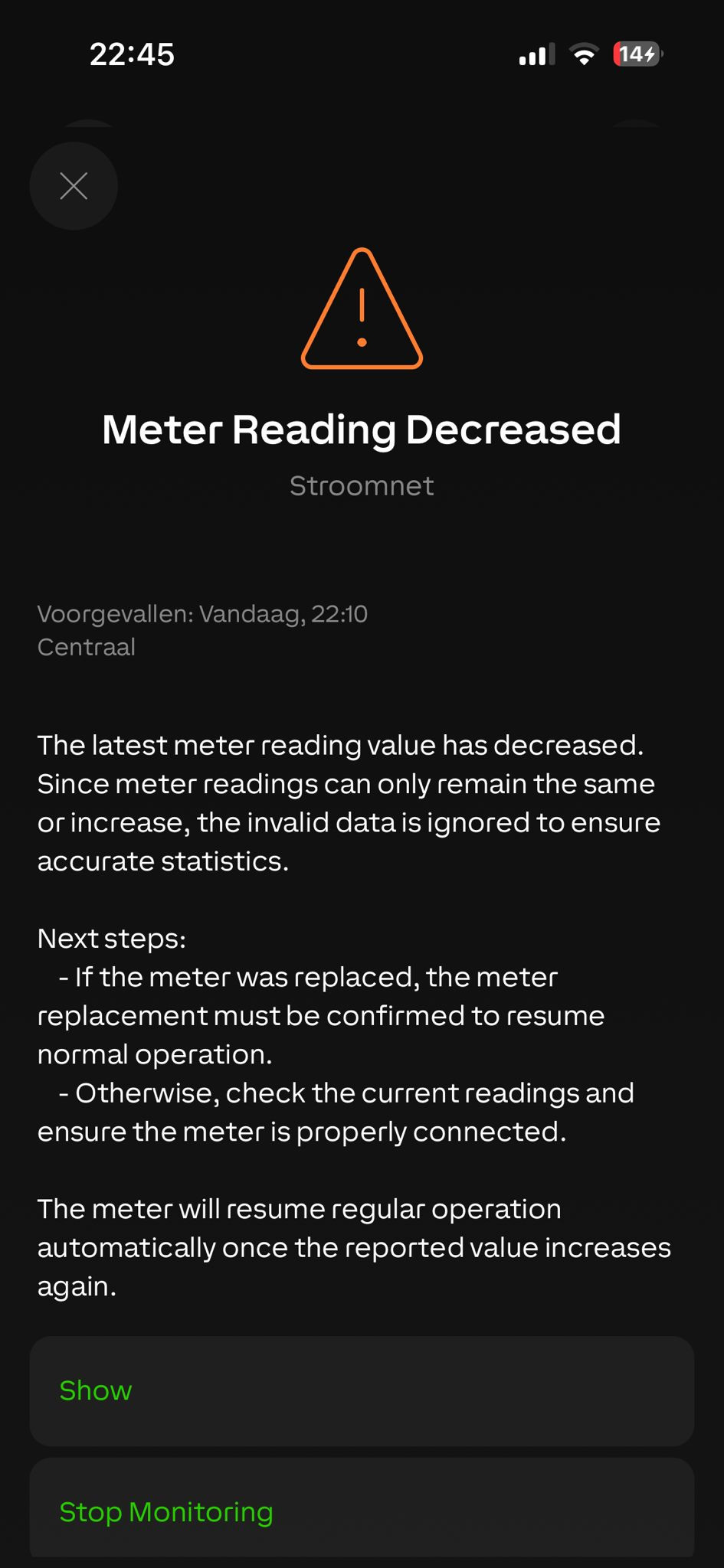

    Hello Everyone.
    I updated to config 17 earlier this week and since that time I'm experiencing issues with the data for grid import/export.
    I've been using the default config from the solaredge integration (this one).
    I've a battery and solar panels attached as well as measurements for the heat pump and pool house. All of those measurements still seem to be fine.
    The issue i'm seeing is on the M_Import and M_export. They are connected to the grid bidirectional meter on Mrc and Mrd. If I'm using live view I notice they are about 6670kwh and 1390kwh which seems strange. It might be the cumulative? not even sure exactly.
    If i go into the enery flow monitor in the app I see if it's on the power tab all data seems to be correct. But as soon as I move to the day tab for instance I notice wild consumption data for grid.
    Like 1mwh per day while other consumers are not even close to that.
    I've also added some video's of what is happening visually.
    Also I get an error/warning once a day since the update that tells me "Meter Reading Decreased" It gives me the option to reset meter readings. but I'm afraid by doing so I'll lose all my previous recorded data.
    I'm hoping someone can tell me what's going on and how I can fix this.
