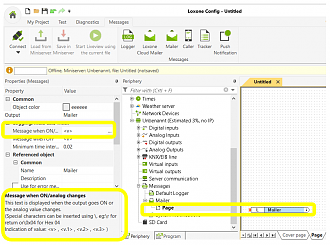

    is it possible not only to send static text as notification via Mailer, but also to send the actual value? I have set up an alert for temperature in the house dropping too low - temperature inputs going into "Min Max" (to find the minimum temperature), then "Less" comparison and into mailer. But I haven't figured out how to write any valu in the mail body.

    • 5178
    <v> (<v.1>, <v.2>, <v.3>) will show the value.
    Example:
    temperature is 10.1°
    notification: minimum temperature <v.1> °
    Result: minimum temperature 10.1°

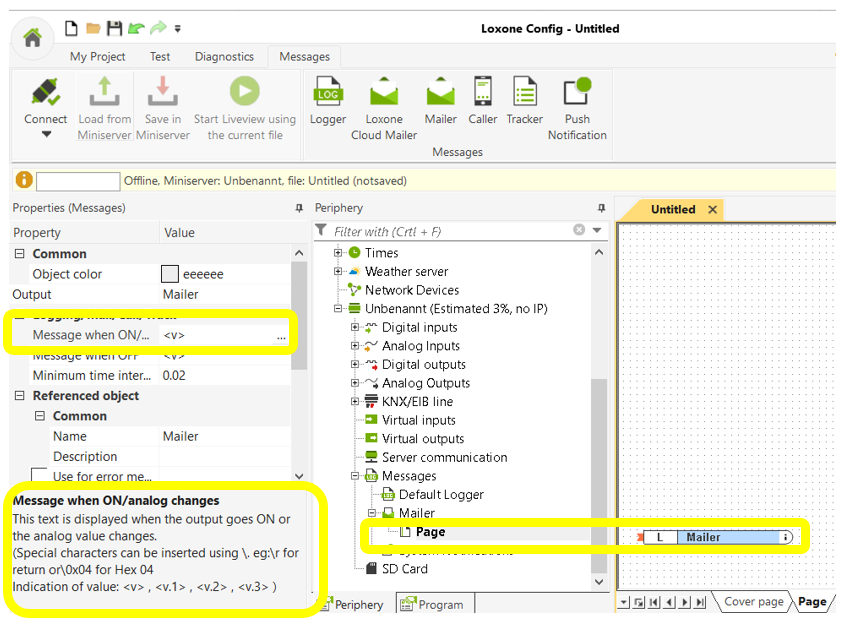

        • 5178
        If you select the property field, it shows a description below..

          Yes, I have seen that but I assume there are other variables which are not documented there..

          • 5178
          Maybe, there are other variables, but I don't now.
          This is the only dokumentation I found.

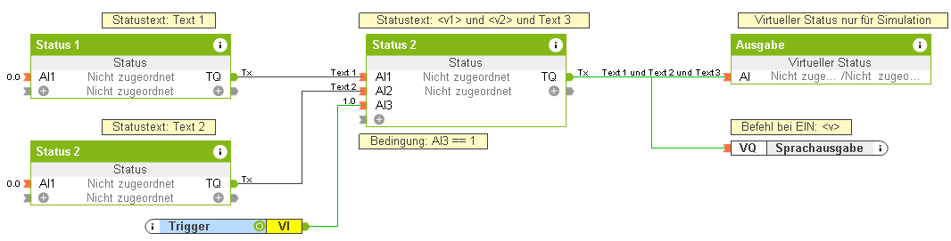

            Hi romildo,
            I see. So it's not that a digital pulse activates the Mailer and I'd be able to fetch some additional data (as there are no other inputs). I can use always only one value. Based on my requirements (like to notify only once, when temperature drops below 18 deg.) I have to add some other controls in between to make sure the analog value gets changed only once, when the temperature drops. Am I correct? Or is there any way how to pass more than one value into the e-mail, for instance "Today, it is 10 degrees Celsius and the wind is blowing at 10km/h"?
            Thanks,
            Aleq
              • 5178
              You can take a status.
