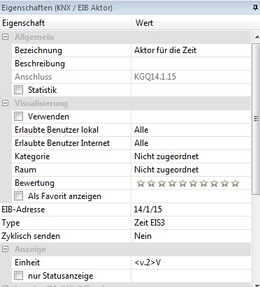

    How can I read the loxone server current dateor time?
    I don't find a way to do that
    I need to send the current time to my knx button
    I only find a way to tick at regular interval (each hour) but I can not read the time of the tick

        How merge the hour and minute variable and most importantly convert the value to a KNX datatype?

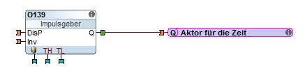

          From an old Loxone example.
          The pulse generator triggers every 5 minutes, to send the time every 5 minutes.
          But, short disclaimer, I haven't used this to date.
