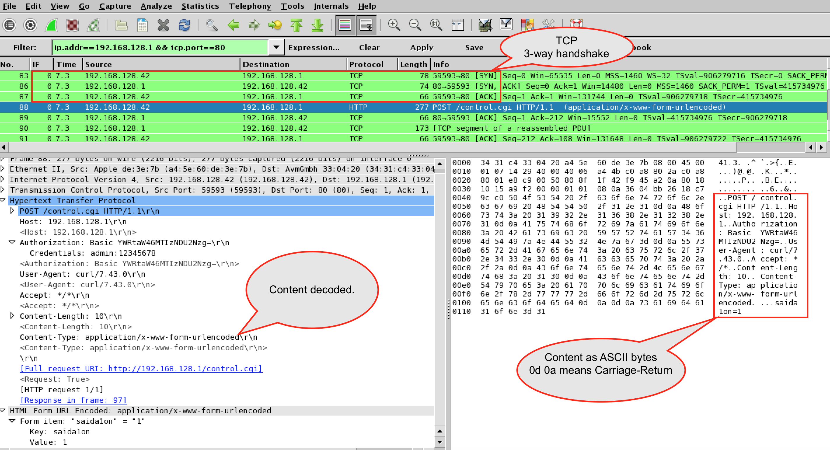

                  • Jan W.
                    • 30.08.2015
                    • 1613
                    Hi Honzapp,
                    your screenshot from Wireshark shows that the TCP 3-way handshake is not finished. You see the first packet (TCP SYN) repeated a couple of times, but never any response. This indicates that there is no server running on the port - in this case no server on TCP port 80.
                    Just to give you an idea, what you should see I've quickly send the following command via curl to my Internet router (IP-address 192.168.128.1) which is listening to port 80:
                    curl --request POST 'http://admin:12345678@192.168.128.1/control.cgi' --data "saida1on=1"
                    With Wireshark I can see the HTTP request and all the content. Here it's even decoded as HTML
Name: Bildschirmfoto 2016-09-08 um 18.32.10.png
Ansichten: 5493
Größe: 415,9 KB
                    The content that I was sending (with curl) might not be correct for your relay board, but it was quicker for me than to try to implement the http input on my MS. If I look into the content it is almost the same as your code from post #2.
                    Try to capture packets from the MS to your PC again with a web server running and compare it to packets that are captured from your PC / web browser to the relay board where you said that this works and you are able to control the relay board.
                    It might be easier to use TCP / Telnet directly as Christian has suggested, but troubleshooting would work the same way. Most of the overhead with HTTP POST is done by the MS already.
                    Cheers,
                    Jan
