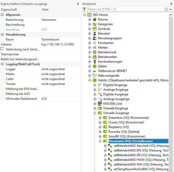

    - create a virtual input in loxone for each status they are named like this one "VIHeating_Temperature_Outdoor"

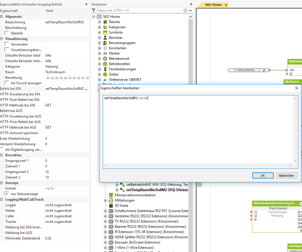

    - add the cgi script to send commands from loxone to the viessman heater
    - add any required commands to loxone as virtual output
    you can test in a brower using "http://192.168.x.x/cgi-bin/cgi-vclient.sh?setBetriebsArtM1To5"
    If you put these commands in a virtual output loxone can control your heater.

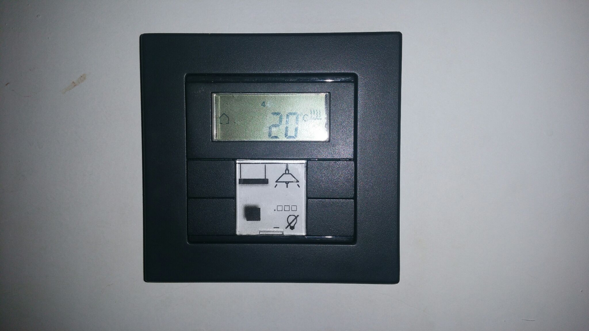

          I use KNX with loxone, part of the heating control is done in the knx thermostat i have in each room I want to control.
          This makes it more complicated to explain.
          My setup is a mixture of KNX and Loxone.
          Up to a few months ago I only controlled the radiator heating circuit.
          I am working on adding the floor heating and controlling it.
          It makes that I have a slow and a fast heating circuit in some rooms.
          I am almost sure that it will work, but that is not all working and tested now.
          Some of the thermostats are a merten/schneider model, there are others.
          See picture.

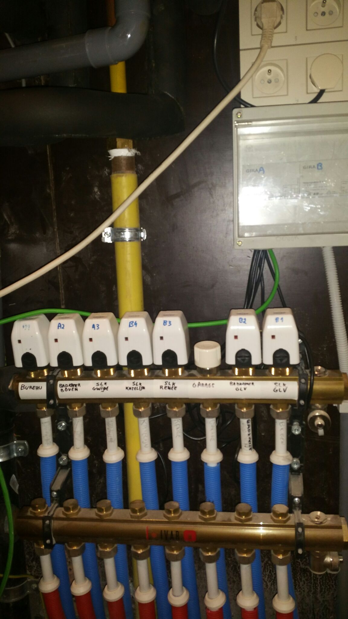

          The valves are also from schneider/eberle (I recently bought this one http://www.eberle.de/product.aspx?id=2384)
          The valves are all connected to a knx module (gira 1018 00, or 2114 00)
          see Picture of the valves
          I added some pictures from loxone and ets.
          This helps to give you an idea, but this is not the easiest part to automate.

                    Hello Henk,
                    The output via Telnet works without problems. For setting, see pictures.
                    • henk.oosterlinck
                      • 17.06.2016
                      • 18
                      I changed my intitial script "cgi-vclient.sh" so it would accept parameters.
                      Instead of passing "setBeteriebsArtM1to3" you can use it with parameters like "setBetriebsArtM1 3".
                      Wanted to share this here.
                      The cgi script is a workaround for the telnet that was not working.
                      Telnet seems to be working, I will try this.
                      Thanks a lot for this feedback.
