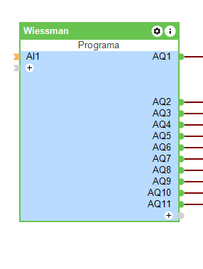

          Hi, I have used the tcp virtual output and it works very well. I created a picoC program to read values directly via the tcp connection. this is what I use.
          #define BUFF_SIZE 40000
          #define RD_BLOCK_SIZE 128

          while(true)
            setOutputs("getModo\ngetTemperaturaAguaCaliente\ng etTemperaturaAguaCalienteDeseado\ngetDesplCalefacc ion\ngetDesplRefrigeracion\ngetInclinacionCalefacc ion\ngetInclinacionRefrigeracion\ngetTemperaturaFl ujo\ngetTemperaturaRetorno\ngetTemperaturaDeseadaC asaCalef\ngetTemperaturaDeseadaCasaRefr\n");
            sleep(25000);
          Klicke auf die Grafik für eine vergrößerte Ansicht  Name: Captura de pantalla 2021-07-29 a las 15.14.12.png Ansichten: 38 Größe: 8,7 KB ID: 313048
          You have to change the IP and the command names. I have 11 outputs, all float (none is text). I guess that this would be easy to modify for everybody.
          I have a miniserver gen 2, if you have a gen1 you might want to increase the read period. It is set to 20 seconds. You might also want to increase the 50ms sleep for a miniserver gen1.
          UPDATE: I added a check for the IP/PORT of the vcontrold so if it is not available the picoc program doesn't get disabled. I also relaxed a bit the timings
