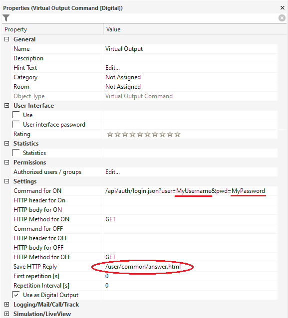

        Hello. I am asking for your advice. I am solving API communication between Loxone Miniserver and OZW672. How did you do it? It doesn't work for me because I'm making a mistake somewhere. What do I have to do first? Where should I put the command 192.168.1.101/api/auth/login.json?user=Administrator&pwd=xxxxxxxxx
        Excuse my pronunciation, I come from Slovakia.​

          I don't have a OZW672, but I'm just using experience with general Loxone functions. Unfortunately this process is quiet complex when a SessionID is required to make a subsequent request to a device. It should be possible though.

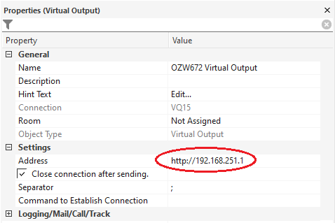

          You will need to create a Virtual Output first. This can be triggered by a variety of means but just create a Virtual Input Push Button to start. The Virtual Output will poll the OZW672 to retrieve the SessionID that will be used later.

          The Virtual Output should have the 'Address' replaced with that of the OZW672.
          Klicke auf die Grafik für eine vergrößerte Ansicht  Name: OZW672 Address.png Ansichten: 0 Größe: 14,9 KB ID: 378326
          The Virtual Output 'Command for ON' should look like this -
          (MyUsername and MyPassword are the credentials for the OZW672)
          Klicke auf die Grafik für eine vergrößerte Ansicht  Name: Username.png Ansichten: 0 Größe: 31,4 KB ID: 378327
          Ensure you enter the 'Save HTTP Reply' text and change MyUsername and MyPassword to the credentials of your OZW672. Save this in the Miniserver, then trigger the Virtual Output using the Push Button created earlier. Nothing will be visible as a response, but the Miniserver will poll the OZW672 and should save the SessionID to a file on the Miniserver SD card.
