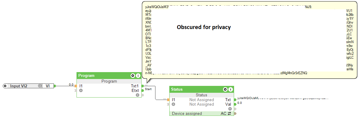

    It works!
Ansichten: 263
Größe: 33,1 KB
    I needed to make a change to strl length to 7200 on account of the file size. The program also complained about a couple of things -
    const char IdToken[20] = "\"IdToken\":\"";
    I removed the term const and it doesn't complain. I'm not sure what other issues that might present?
    [len] = 0;  // add trailing 0 to token string
    I commented out the entire line with //. This stopped the error text. It probably causes the next issue...
    The token generated is correct except that it is missing the first letter e. The beginning should be -
    eyJraWQiQiJsM3....
    The program is now -

      Congratulations! The "const" may be removed without any consequences. The line
      tokenStart += strlen(IdToken); // if found then add length of token itself
      can be changed to
      tokenStart = tokenStart + strlen(IdToken) -1; // if found then add length of token itself
      to subtract one character. Im not sure why you got an error at
      token[len] = 0; // add trailing 0 to token string
      The word "token" was missing in your post, but was included in my example. Maybe that's the reason for the error? The function "strncpy" copies the entire string, but strings in C needs to be terminated by a byte with 0 (zero). The string "str1" might be initialized with 0 (zeros) automatically at the first start of the program, but if the length of the token may change (gets shorter), it could result in an invalid token containing the rest of the previous one. For safety reasons I would try to add that line of code. If you still get errors, try
      token[len] = (char) 0; // add trailing 0 to token string

        HelloJan W. I'm happy to report all those fixes worked. I've reproduced the code below. The program is very useful for doing OAuth 2.0 on the Miniserver in a standalone capacity. The full steps require a bit of a work-around in saving to the user/common directory, but at least the option exists for standalone authentication.
