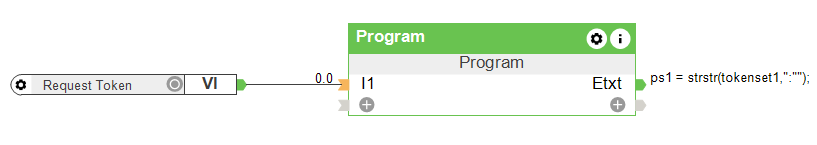

                    Hello Labmaster. Now the Config v14.4.9.25 is released and supports 4096 bytes from the setoutputtext. I'm trying to 'in-source' an external logic on a Raspberry Pi into the Miniserver logic. My use-case is exactly the same as the intent of the script in this thread. That is to extract a multi-character token from a file saved internally on the Miniserver and set it at the Txt1 output.
                    I'm attempting to modify the script at the beginning of this thread (Post #4) but have little clue with PicoC. I have altered the code to adjust to my application. My file has one instance of the term IDToken and looks like this in the file -
                    "IdToken":"eyJra......etc." (1960 character token)
                    Original line: fp1 = fopen("/user/common/smaxtoken.xml", "r");
                    Altered line: fp1 = fopen("/user/common/zodiac_token.json", "r");
                    Original line:
                    p1 = strstr(str1,"token");
                    tokenset1 = strstrskip(p1,"token");
                    Altered line:
                    p1 = strstr(str1,"IDToken");
                    tokenset1 = strstrskip(p1,"IDToken");
                    This results in the following error -
                    Klicke auf die Grafik für eine vergrößerte Ansicht  Name: PicoC block.png Ansichten: 0 Größe: 10,0 KB ID: 405326
                    Any hints on what to look for? I've consulted ChatGPT but the suggested code ends with ongoing and different error descriptions.
                    edit: ChatGPT says the error occurs because "you are trying to assign a value to a character array (ps1) using the strstr function, which returns a pointer to the first occurrence of the specified substring in the given string. You cannot directly assign a pointer to a character array in C. To fix this issue, you need to use strcpy or strncpy to copy the content of the tokenset1 pointer to the ps1 character array.​"​

                      @Tico: I'm not sure what substring you are searching for. Is it :" ? Then the quote symbol needs to be escaped with a backslash, see https://stackoverflow.com/questions/...te-in-c-string
                      The resulting line of code would be
                      ps1 = strstr(tokenset1,":\"");
                      (same two lines below)
                      EDIT: it look that pasting in code as normal text with backslash in the forum would result in loosing the backslash. After I have enclosed the code with the code brackets, I got the expected result. That might be the reason why the code from # 4 (that seems to have worked) would result in invalid code when you've copied the code.
                      Zuletzt geändert von Jan W.; 30.09.2023, 10:14.

                        I corrected the two lines that appear to have been corrupted by the forum -
                        token1 = strstrskip(p1,":\"");​
                        That has resolved the error displayed. Unfortunately, I don't get the IDToken displayed at the Txt1 output. The program doesn't appear to do anything.
                        I also assumed the code worked in Post #4. However, I don't know if there's anything special about the file the program was built to use. My file has lots of random text before the token I wish to extract. The specific text that I need to identify is "IdToken":"eyJraWQiOiJsM3V0VHAyZGJReGtyalF.... (cha racters removed for brevity)....SrEZNQ"
                        The text "IDToken" only appears once in my file -
                        ....29A.U3ABrBUFGxQPTMRqfS3zYQ","IdToken":"eyJraWQiOiJsM3V0VHAyZGJReGtyalFMc....
                        I need the text output eyJraWQiOiJsM3V0VHAyZGJReGtyalF........SrEZNQ (composed of a 1960 character token).
                        I also don't understand whether the program runs continuously or needs a trigger to start.​

                          Hi Tico,
                          it looks that the missing backslash might not be the only problem. I really like Pico C and have used it for two programs (Helios ventilation system for tricky modbus integration and average wind speed) in my Loxone installation that runs for about 9 years now. Due to limited information, e.g. about the content of the file zodiac_token.json, I may only be able to help you solving the problem to extract the token from the file. Here's some example code for a matching pico c program:
                          FILE *fp1;
                          char str1[4095];
                          char *tokenStart;
                          char *tokenEnd;
                          char token[4095];
                          const char IDtoken[20] = "\"IdToken\":\"";
                          int len;
                          int nEvents;
                          while(TRUE)
                              nEvents = getinputevent();
                              if (nEvents & 0x08)             // check for change on analogue input 1 (Bit 4) - this is only used as a trigger to run following code
                                  fp1 = fopen("/user/common/zodiac_token.json", "r");  // open file with token for read
                                  fgets(str1, 4095, fp1);     // copy content of file to string, max. 4094 bytes plus trailing 0
                                  tokenStart = strstr(str1, IDtoken);       // search for IDtoken in string
                                  if (tokenStart != NULL) {
                                      tokenStart += strlen(IDtoken);        // if found then add length of token itself
                                      tokenEnd = strstr(tokenStart, "\"");  // search for final quotation symbol
                                      if (tokenEnd != NULL) {
                                          len = tokenEnd - tokenStart;      // if found then calculate length of token
                                          strncpy(token, tokenStart, len);  // copy n bytes from string to token starting from begin of token
                                          token[len] = 0;                   // add trailing 0 to token string
                                          setoutput(0,len);                 // set analogue output 1 to length of token
                                          setoutputtext(0,token);           // set text output 1 to token
                                  } else {
                                      setoutputtext(0,"");                  // clear output if no token is found
                                      setoutput(0,0);
                                  fclose(fp1);
                              sleep(500);                                   // sleep for half a second
                          To run the program, you need a trigger on the AI1, but that input is not used in the program itself. I have no idea, if the token needs to be cleared in the output when no token is found, but the code has some comments and may be a good starting point. Labmaster is right, that the code needs to be efficient and should not run too often to consume as little CPU cycles as needed. I've changed the sleep timer from 30 seconds to 0,5 seconds, but have included an event checker (getinputevent), so the code only consumes a few cycles if there is no change on AI1. A "free" function is only required if dynamic memory is allocated, but not for static strings.
                          I haven't tested the code on my MS so there might be still a syntax error in the code, but without a proper token file and and a connection to a system that requires that token, it would make no sense. However I've tested the main logic code statements online at https://www.tutorialspoint.com/compile_c_online.php with the following code
                          #include <stdio.h>
                          #include <string.h>
                          char str1[4095] = "The specific text that I need to identify is \"IdToken\":\"eyJraWQiOiJsM3V0VHAyZGJReGtyal .... (characters removed for brevity)....SrEZNQ\"bla bla";
                          char *tokenStart;
                          char *tokenEnd;
                          char token[4095];
                          int len;
                          int main () {
                                          strncpy(token,tokenStart, len);
                                          token[len] = 0;
                                          printf("The token is: >>>%s<<<\n", token);
                                      } else
                                          printf("IDtoken found, but no quotation at the end");
                                  } else
                                      printf("IDtoken not found\n");
                          I was surprised that Loxone has extended the length in setoutputtext in v14.4.9.25, and hope that the code might help to solve your problem and may also help to improve the code for Rick_Pa_87.
