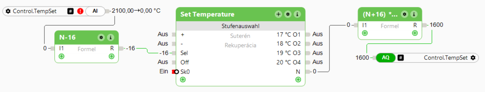

    I have a Modbus analog sensor, and also a Modbus analog actor.

    I want to make the value editable. What widget should I use between two of them to change the value of the temperature?
    The sensor has as display "Schieber/Slider", but it never appears as a slider.
    Thanks for your help.

    I would check the "Dimmer" or "EIB Dimmer" function Blocks for in between.
    They are highly configurable to fit the needs.

      The Dimmer has only percentage (%) values (not absolutevalues ) and an On/Off button... not something you need when changing the temperature.
      Please Loxone, there must be some simple universal slider or gauge that change values between min and max with a certain step. Maybe with two alarms when the values rise or drop beyond some limits.
      (Just like there is a Switch, and the crooked Status/Radio elements)
      We can use it for setting temperature, pressure, speed, volume and many, many other things.

        To make my invested energy useful for others, this is the final solution I am more or less satisfied with...
