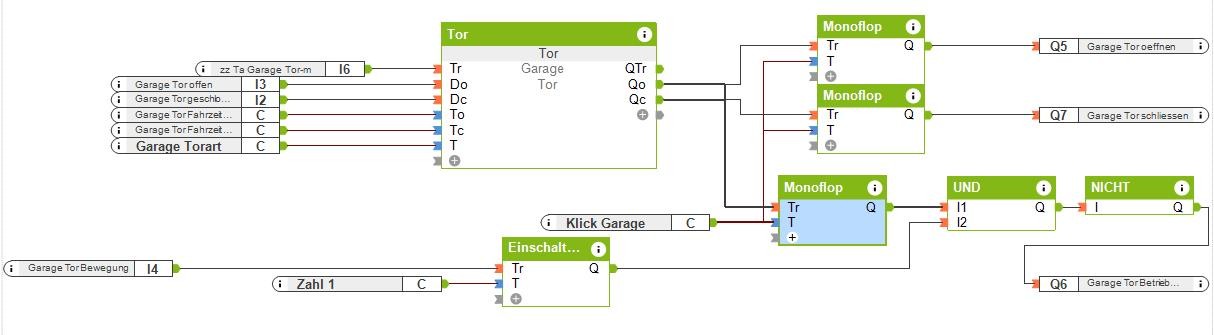

    Hello Aleq,
    I am using the UAP1 for more than 1 year and it is working very well. With the right setup in the LoxoneConfig it is also recognizing the movments caused by the heormann remote control. Attache my configuration (I hope the German is working for you. If not, just let me know.
    The "Tor in Bewegung I4" Output must be changed in the UAP1 to "garage door in movment" to work with the Config above.

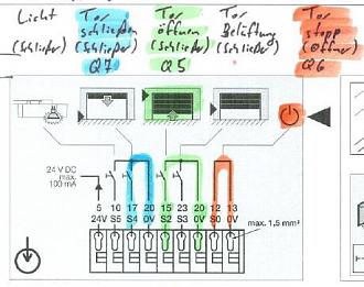

            Concerning your questions:
            - UAP1 module is getting power through BUS cable connection from Hormann Supramatic itself? (Hormann Supramatic still connected to a power socket).
            --> Correct.
            - For the 3 inputs I2, I3, I4 - one CAT7 cable (or SVV8x0,8) would be sufficient?
            - For the 3 outputs Q5, Q6, Q7 - what kind of cable(s) would i need? Looks like 3 times 3G1,5 would do the trick?
            --> The important thing is that you need 12 wire in total. 6 from Loxone to UAP1 and 6 from UAP to Loxone. Non of the lines are bus signal and in my setup I use none as high voltage. So this is why I have used a 12 wire "telephone" cabel. My connetion distance between Loxone and UAP1 ist not very long. I guess it should do for longer distances, too, but I am not an electrician. CAT7 should do it too.
            - Would like to combine this engine with automatic fuse 6A from my screens. What kind of fuse is recommended?
            --> I am not an electrician. I can not answer this.
              Hi chrispie ,
              Thank you very much for your useful and very fast feedback!
              With the Q5, Q6, Q7 being connected to Loxone relay output i was thinking it needed 230/240V (high voltage) but the Loxone relay output is acting here as a "signal switch" (not sure how to call this - so far only used Loxone Relay to switch 230V/high voltage outputs).
              Based on what you are telling me this is not required. You just connected the 6 wires of Q5, Q6, Q7 directly on the Loxone Relay (outputs) without getting any line/high voltage from an automatic fuse (230V) or maybe power source (24V)?
              If you could confirm, I'll probably then pull the following wires:
              - 2 times CAT7 to avoid having to get another type of singal cable just for this short connection (for the 12 wires)
              - 1 time XVB 5G1,5 (just to be future proof as future engines might just require the 4 wired approach over high voltage).
              • chrispie
                • 05.11.2015
                • 15
                You got it right. The Loxone relays for Q5,Q6,Q7 are acting as on/off switches, only. Connect the Loxone Relays to the UAP1, directly. No connection to any supply source 230V or 24V. The required power to detect on/off is supplied by the UAP1.

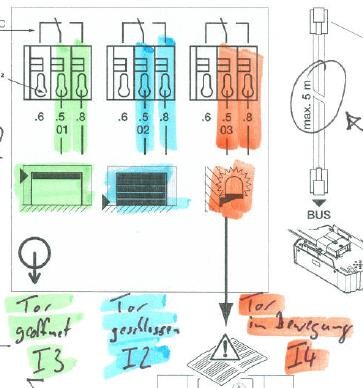

                    I remember that I had to change the relais output to "gate is moving" in the Hoerman Supramatic (I guess ist was menue point 29). May be the other I have set up as required, too. I am not sure because I have done it some time ago. The good thing with Loxone is, that you can test it step by step.

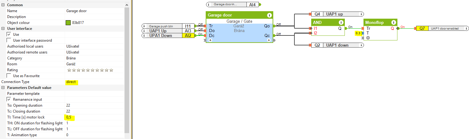

                        Hello all,
                        thanks to extremely useful information from chrispie it's finally working for me. The key was to use 12-13 (chrispie's "Tor stopp Q6" for ref), because without it, Hörmann UAP1 does not react like Loxone Garage door controller. For instance, when the door is being opened and you press up, Loxone stops. UAP1 still continues. If the door is going down and you press up, Loxone stops, UAP1 changes direction and starts opening, etc. This had to be reset by opening closed 12-13 contact. In my first version I just linked this to the operation of Loxone door controller, whenever there was no output (up or down), 12-13 was open (which stopped but then kept blocking everything). This blocked the remote controls, so I changed this to Monoflop - a short opening of 12-13 contact is enough. This value needs to be shorther than Motor lock configuration value (otherwise it may block more then we need) and longer or equal than 0,3s as that proven as reliably recognizable by UAP1.
                        This is my simplified version:
                        All you need is
                        Loxone outputs:
                        - UAP1 command up (15-20, chrispie's Q5) - Q4 on my image
                        - UAP1 command down (17-20, chrispie's Q7) - Q2 on my image
                        - UAP1 enabled switch (12-13, chrispie's Q6) - Q7 on my image; doors are operational if this output is ON, door motion stop immediately and the door start ignoring any command when this output is OFF
                        Loxone inputs:
                        - UAP1 signaling the door is fully open (01, chrispie's I3) - AI3 on my image
                        - UAP2 signaling the door is fully closed (02, chrispie's I2) - AI2 on my image
                        Optional (not used by the control block):
                        - Supramatic Menu Item 29 configured providing AI4 (03, chrispie's I4 for ref): garage door in motion
                        Don't forget to set the Loxone Garage door control block to DIRECT Connection type (outputs steady on/off during operation, instead of default impulses) and make sure the Monoflop time is shorter than Motor lock.
                        Note: I'm using AIx (analog inputs) switched into digital mode becase I have ran out of digital ones. There is no other reason for this.
                        Thanks a lot chrispie.
                        Best regards,
                        Aleš

                            "Optional (not used by the control block):
                            - Supramatic Menu Item 29 configured providing AI4 (03, chrispie's I4 for ref): garage door in motion"
                            I can not find any information on this menu item in the manual. Is the "29" a page number, picture number, etc.
                            Could you please give some more directions? (e.g. copy the page that this info is on, and explain how to set it?)
                            • Aleq
                              • 04.05.2016
                              • 53
                              Settings option #29.
