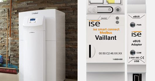

    I have two options to connect my new vaillant geotherm installation.
    Both of these options requeire a module from ISE one is KNX based the other one MODBUS server.
    In light of the new controller im wondering what the best choise whould be
    Together with the system controllers sensoCOMFORT or multiMATIC, the SMART CONNECT KNX VAILLANT offers integration between eBUS and KNX.
    As a Modbus TCP/IP gateway, the SMART CONNECT Modbus Vaillant offers access to a Vaillant geoTHERM/3 heatpump, as well as to three Vaillant VR60 mixer modules and up to six Vaillant VR90 remote control devices.
    please help me disside

    I am a frequent user of Modbus/Loxone with a solar/battery installation. I have limited use of KNX with one airconditioner.
    Modbus features -
    1. Direct connection to the Miniserver via Modbus TCP (ethernet - no further costs required),
    2. Use within Lox Config is relatively straight forward,
    3. Update rate is good at 5-10 seconds.
    KNX features -
    1. Direct connection to the Miniserver KNX line but external KNX power supply is required (this is a specific 30V supply that is only built for KNX devices),
    2. Use within Loxone is limited to a couple of KNX compatible blocks (one switch and one lighting),
    3. Programming is difficult with a separate programming app called ETS5 for the KNX device. This is a really clunky and non user-friendly app for new users. The ETS5 software is free for less than five KNX devices.
    4. Update rate is programmed via the ETS5 tool.
    I would highly recommend Modbus given the option.

        Raspi + ebus Adapter + Node-Red
        cheaper and much more flexible than the „official“ solution (Check the FHEM Forum die the ebus Adapter.)

          Also a LoxBerry-installation could be a solution:
          I did not test this plugin yet.
          But I do use the referred ebusd along with smarthome.py and a Esera-EBus-Adapter to bring my Vaillant-heatpump VWL 82/3 S into my KNX-system.
