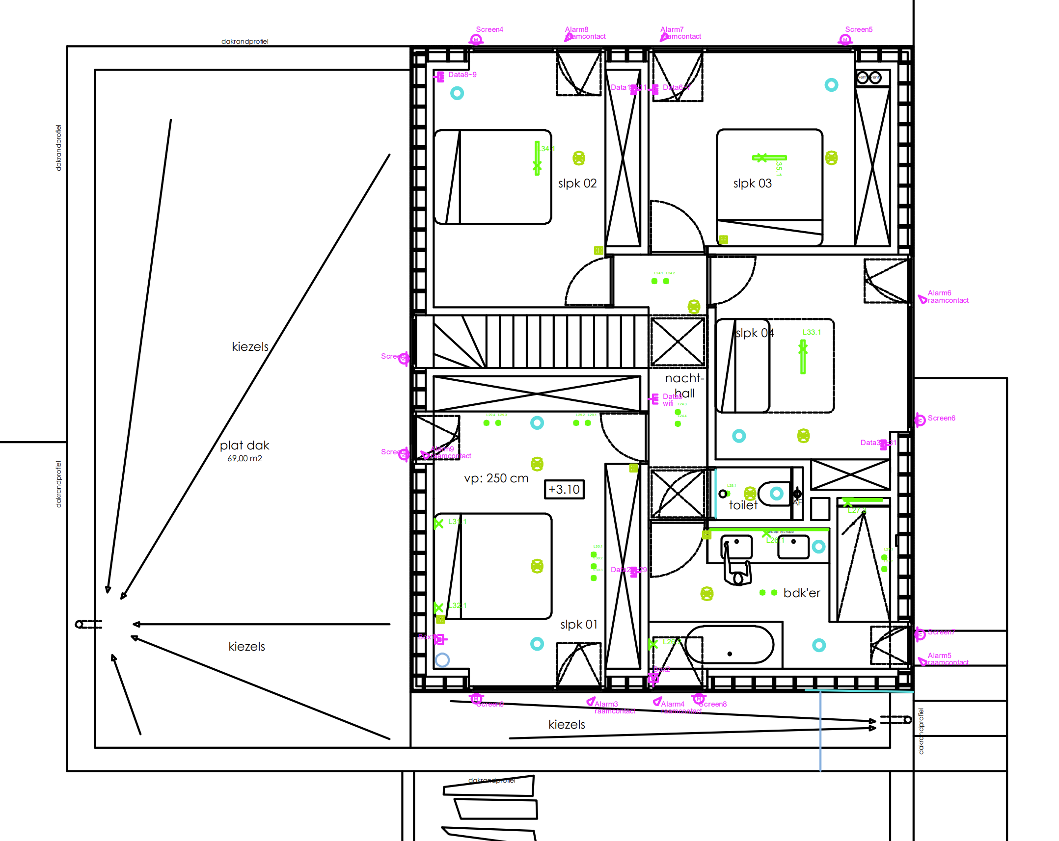

    Hello everyone, we have chosen to implement Loxone for our new home. I am currently looking at the most optimal placement of sensors and buttons. Looking for advice here too .
    I already made a plan on placement of the components. I added these below, including some open questions. I left objects related to ventilation and lighting on the plan so you can see how everything is aligned with each other.
    Small explanation:
    - Blue circles are ventilation valves
    - Small green circles are lighting spots
    - Other green lines are LED strips
    - The Loxone motion sensors are moss green ovals with a cross in the middle
    - The Loxone (or other) touch buttons are moss green squares near some of the doors

    3. Upper floor
    - Motion sensors in each room
    - Touch buttons at each door + at the bed in our bedroom
    => Would you place a sensor on each side of the bed?
    => In the other rooms I would foresee a regular push button near the bed to switch / dim the lights. Good idea?
    Klicke auf die Grafik für eine vergrößerte Ansicht  Name: CadExport3.png Ansichten: 0 Größe: 379,3 KB ID: 300403
    Loxone miniserver will be placed in the garage.
    Currently I use the Tree cable for the motion sensors.
    I am also looking into a solution for Audio / streaming. We currently use 2 Sonos Play devices and I am ready with these. Since we have room in the ceiling, I was thinking to start switching over to in-ceiling speakers. The Sonos in-ceiling speakers are very expensive however, for the many I can buy multiple decent speakers from other vendors. Since I did not invest into Sonos that much yet, the Loxone Audio Server is still an option (max 6 zones). Would anyone recommend the Loxone Audio Server? Any good experiences with streaming?
    If there are things you would do differently => shoot! Open to suggestions for improvements.

          Again many assumptions were made here ...
          The placement of lighting and ventilation have been put on the plan by specialists in their field. Taking into account all the tips I learned from them and reading a lot about it (+ including some logical thinking), I am pretty sure I can place some sensors in places that are most efficient for our use cases. The plan was also validated by an external vendor.
          I came to this forum to get some tips of people who are experienced with Loxone and how they would handle the things I highlighted. There might be things that you would have done differently afterwards.
