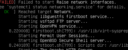

              that is not the case. I setup VM network before installation. 1st boot is correct VM get IP and i am able to handle wizard. After Wizard is finished restard is requirement and than happen this - during boot i see info that network services are unable to start and i dont get any ip adress anymore.
              any idea how to fix this?

                • 5359
                What is that firstboot.sh script? This isn’t a LoxBerry Script. And have you checked systemctl status networking.service as mentioned in the log?

                  i am sorry, i dont anything else than loxberry image (virtual one). i checked it - no info other that it can not be started.

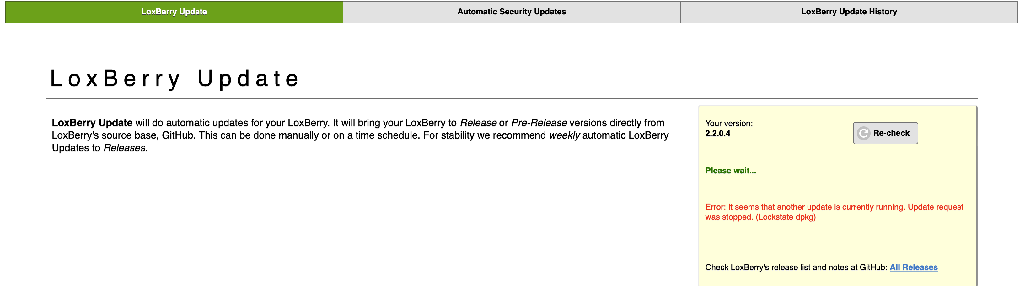

                    so i started to use way with new pass - after restart looks, but no plugin installation or update is possible, because - see attachment.
                    any fix?
                      Wait about 30 Minutes.
                      If it still says the same, try to do
                      sudo apt-get update
                      If this Works.

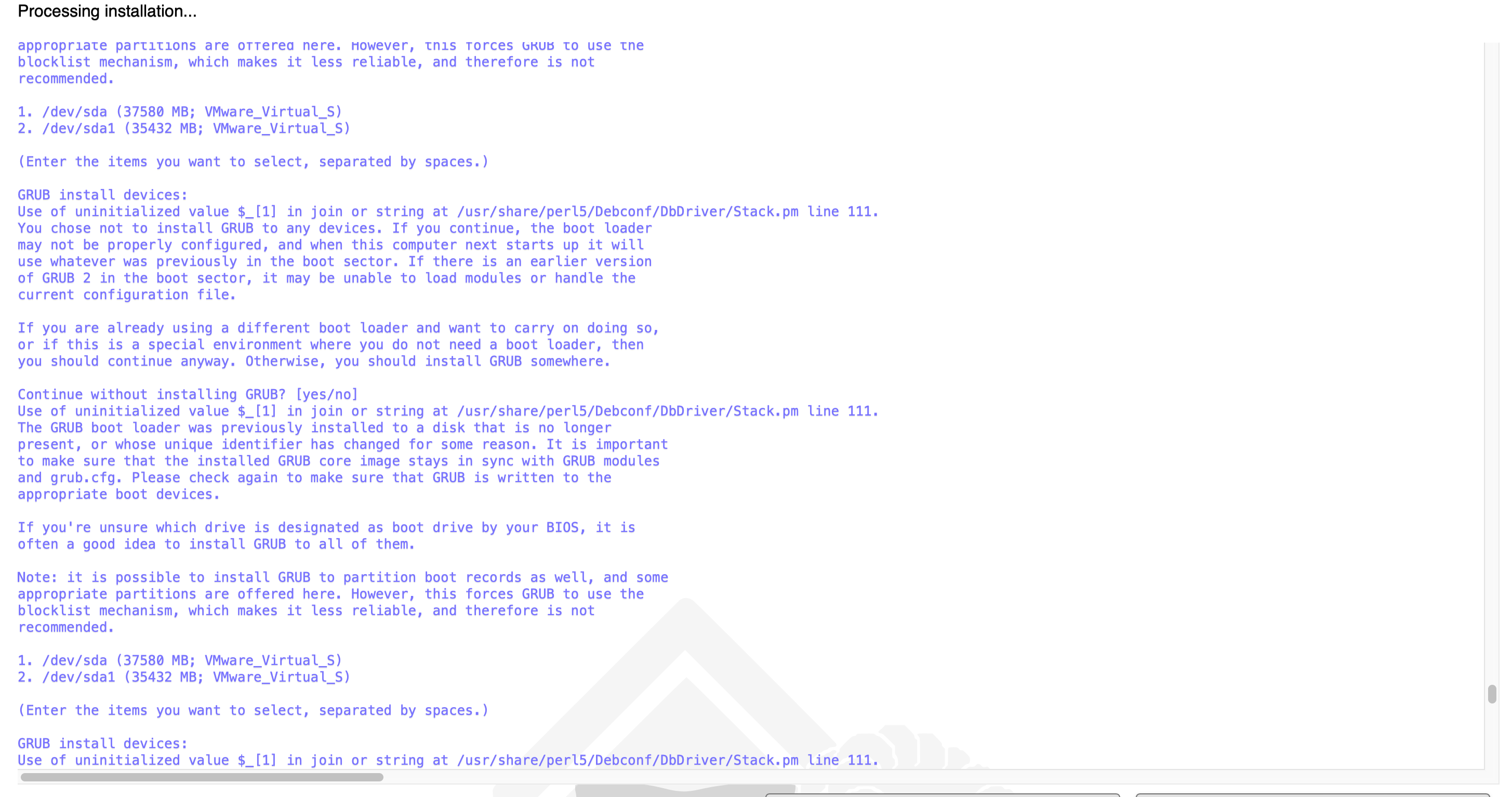

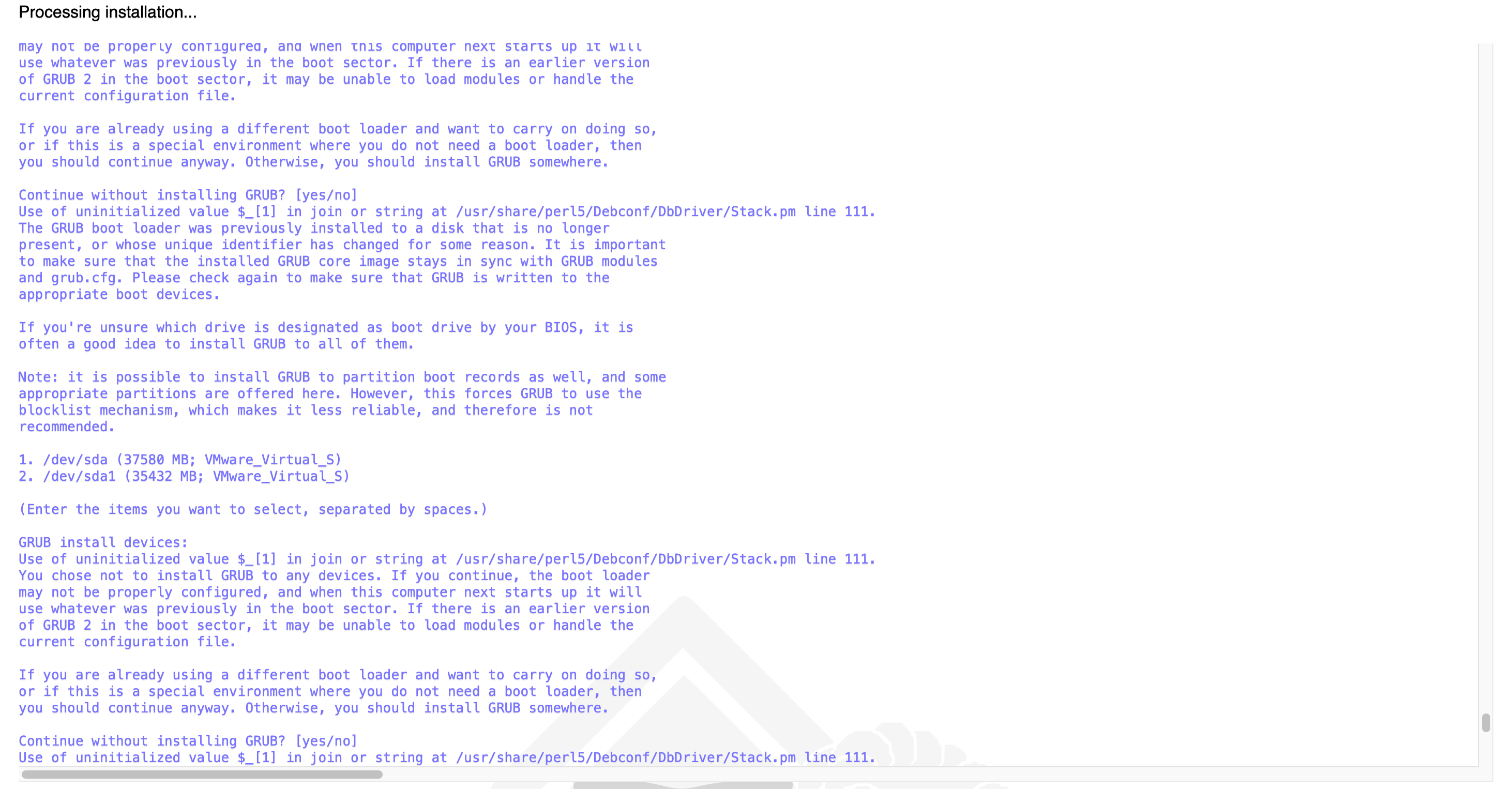

                        seems i am ready for installing plugins, how ever on every plugin installation i got endless messages like this:
                          It seems a problem of the VM with GRUB, we saw this the last days in the German forum.
                          At the VM, get root and try
                          dpkg --reconfigure -a
                          Grub
                          may ask the same questions. Do everything "default" and "keep existing Config" and choices like that, then it should work with Installations later.
                          You possibly need to restart the VM before, to get away hanging dpkg instances.
