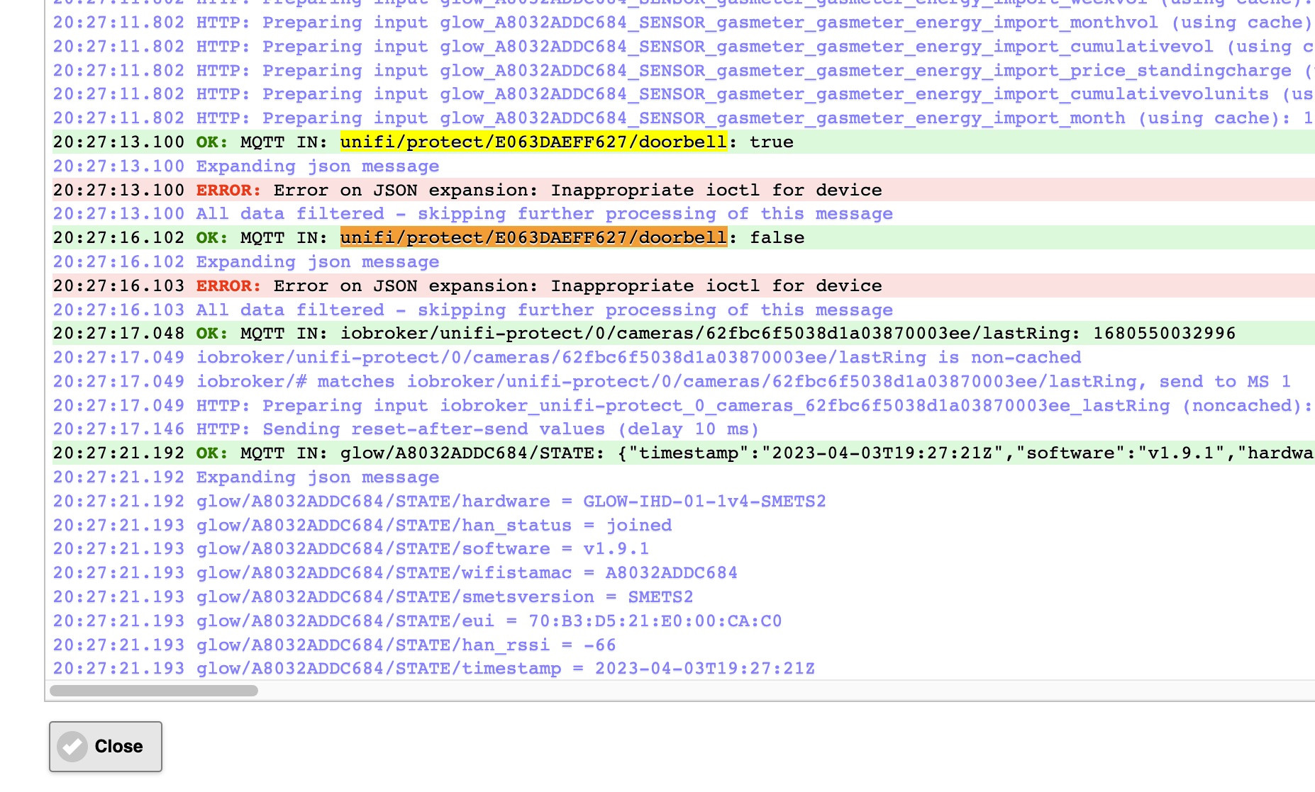

    [SIZE=13px][COLOR=#8080ff][FONT=monospace]1:14:48.194 HTTP: Preparing input glow_A8032ADDC684_STATE_han_status (using cache): joined[/FONT][/COLOR][/SIZE]
    [SIZE=13px][COLOR=#8080ff][FONT=monospace]11:14:48.194 HTTP: Preparing input glow_A8032ADDC684_STATE_software (using cache): v1.8.13[/FONT][/COLOR][/SIZE]
    [SIZE=13px][COLOR=#000000][FONT=monospace]11:14:53.553 [COLOR=green][B]OK:[/B][/COLOR] MQTT IN: unifi/protect/E063DAEFF627/motion: false[/FONT][/COLOR][/SIZE]
    [SIZE=13px][COLOR=#8080ff][FONT=monospace]11:14:53.554 Expanding json message[/FONT][/COLOR][/SIZE]
    [SIZE=13px][COLOR=#000000][FONT=monospace]11:14:53.554 [COLOR=red][B]ERROR:[/B][/COLOR] Error on JSON expansion: Inappropriate ioctl for device[/FONT][/COLOR][/SIZE]
    [SIZE=13px][COLOR=#8080ff][FONT=monospace]11:14:53.554 All data filtered - skipping further processing of this message[/FONT][/COLOR][/SIZE]
    [SIZE=13px][COLOR=#000000][FONT=monospace]11:14:53.555 [COLOR=green][B]OK:[/B][/COLOR] MQTT IN: unifi/protect/E063DAEFF627/motion/smart/person: false[/FONT][/COLOR][/SIZE]
    [SIZE=13px][COLOR=#8080ff][FONT=monospace]11:14:53.555 Expanding json message[/FONT][/COLOR][/SIZE]
    [SIZE=13px][COLOR=#000000][FONT=monospace]11:14:53.556 [COLOR=red][B]ERROR:[/B][/COLOR] Error on JSON expansion: Inappropriate ioctl for device[/FONT][/COLOR][/SIZE]
    [SIZE=13px][COLOR=#8080ff][FONT=monospace]11:14:53.556 All data filtered - skipping further processing of this message[/FONT][/COLOR][/SIZE]

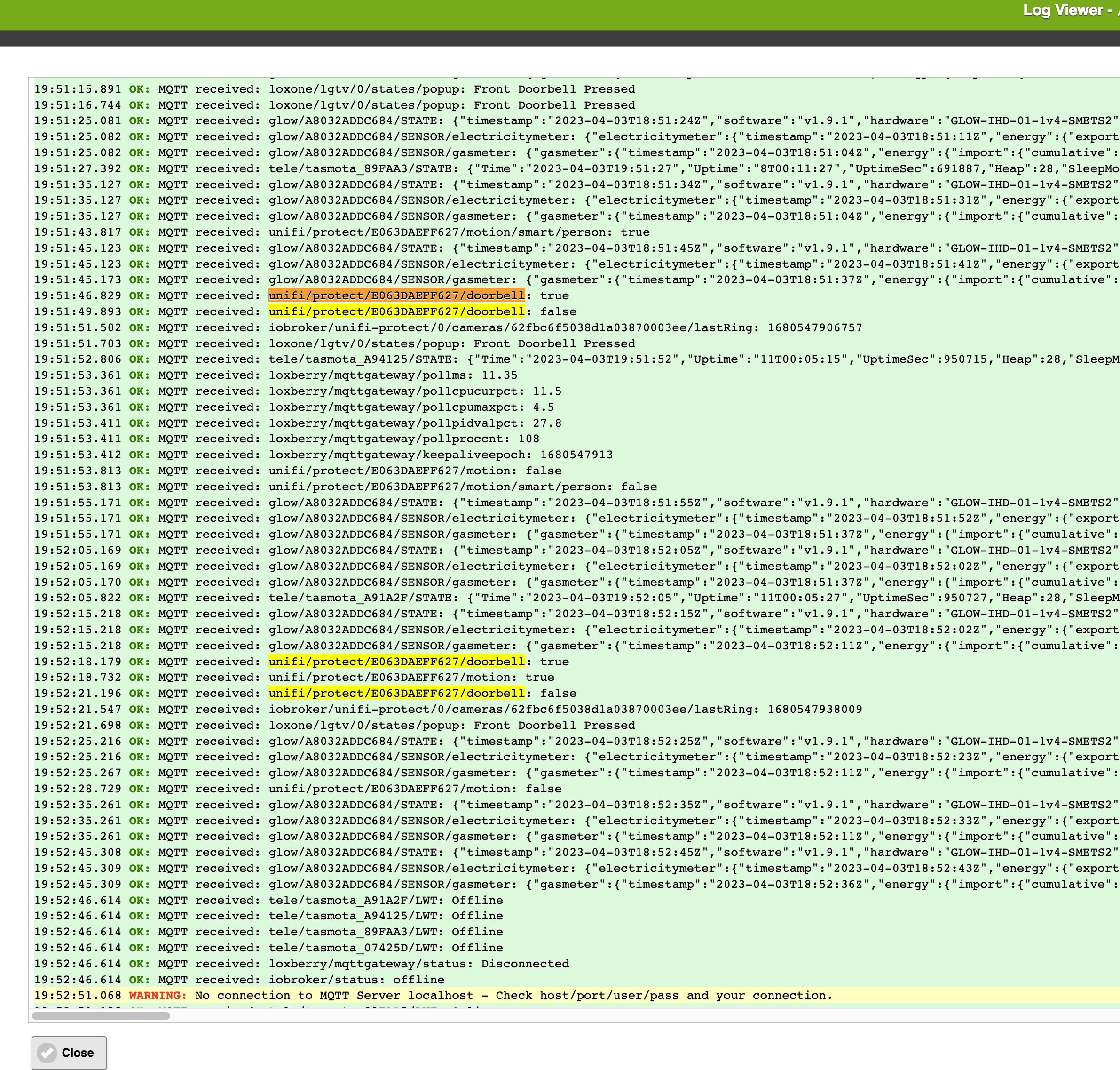

            This is now not generating an error in the log but it is still not appearing in the incoming overview and thus not being sent to the mini-server
            Any help, please?

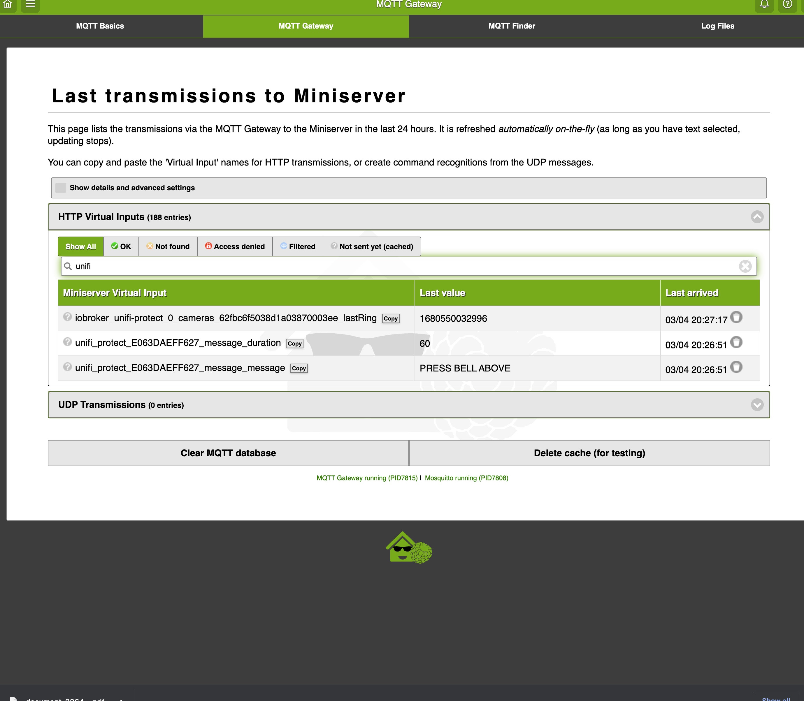

              And here is all that shows in the incoming. The unifi/protect/E063DAEFF627/doorbell is missing
