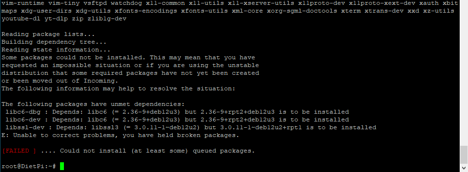

      Hi Prof.Mobilux. I've tried installing a couple of times now without success. The message delivered after a couple of hours is as follows (for both attempts) -
      Klicke auf die Grafik für eine vergrößerte Ansicht  Name: Bookworm install error.png Ansichten: 0 Größe: 32,8 KB ID: 412278
      At his point, I reboot and attempt to access with the browser. I can't log into the browser ("This site can't be reached"). I can SSH into the Loxberry and login using loxberry/loxberry.
      Klicke auf die Grafik für eine vergrößerte Ansicht  Name: Loxberry_DietPi.png Ansichten: 0 Größe: 34,3 KB ID: 412279
      Between the two attempts with Bookworm, I made a clean install with Bullseye and Loxberry 3.0.0.6. This installed fine and seems to exclude my environment from the problem.

        • 5038
        Tico Can you please try the following:
        Install the right DietPi Image on your Pi3 (ArmV8 Image!) and do the DietPi configuration. Then do:
        apt update
        apt install libssl-dev
        apt install libc6-dev
        apt install libc6-dbg
        After that, install LoxBerry as described in the first post with "wget.....".

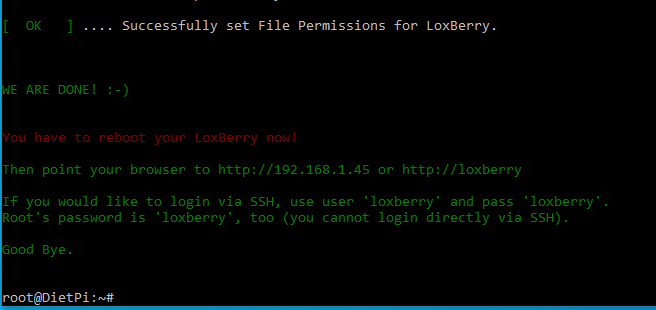

        • Noschvie
          • 24.09.2018
          • 580
          HTML-Code:
          apt update
          apt install libc6-dbg​
          ... executed successfully and "wget....." started now...
          • Noschvie
            • 24.09.2018
            • 580
Ansichten: 961
Größe: 12,4 KB
            ... executed successfully.

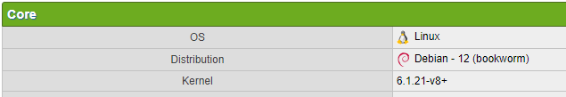

            • Tico
              • 31.08.2016
              • 1035
              Cool! Working fine so far!

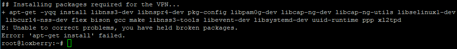

                I've run into a problem trying to install the Loxberry VPN server documented here -
                https://wiki.loxberry.de/modifikatio...erver_machen?s[]=vpn
                The error message is attached -

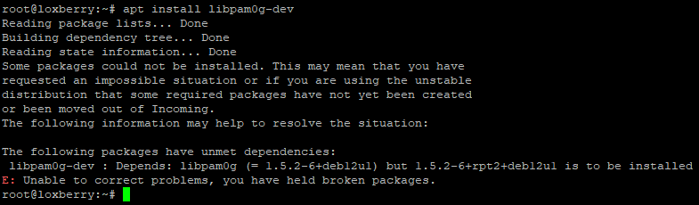

                I've then manually installed each package individually. They are all successful except for libpam0g-dev. This is the error message attached -
Ansichten: 955
Größe: 21,0 KB

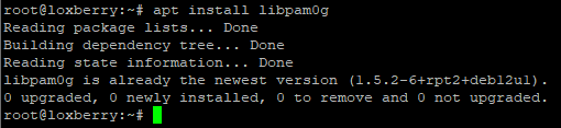

                I then try to install libpam0g (note ommitting the -dev). That gives the message below -
Ansichten: 955
Größe: 8,5 KB
                Any suggestions how to fix this? The VPN server is an essential component of my Loxberry installation.
                  • 5038
                  Thanks! Fixes are included in the installation script.
                    • 5038
                    Tico This is the same F*ckUp with the Raspberry packages... As you see installed is package "....+rpt2+.....", which is the package for Raspberry, but the package depends on the package without "+rpt2+...
                    Don't now how to fix this. I think it's a problem in the main distribution...
