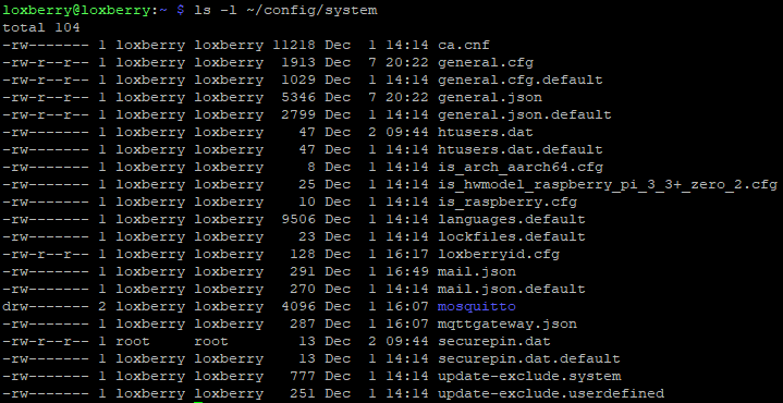

                I've just got around to setting up the MQTT Server in Bookworm/Loxberry. At the MQTT Basics tab, 'Use and automatically configure local MQTT Server' is selected. 'Save and Apply' results in a red 'Error saving data'.
                MQTT Gateway running (PID1234) Mosquito running (PID5678) is green at the bottom of the screen.
                Adding a subscription and selecting 'Save and Apply' also results in a red 'Error saving'
                I've perused the log-files and there's nothing I can see that suggests errors or faults.
                edit: Should MQTT Server hostname be localhost and uneditable?
                  • 5677
                  Works for me here. Please post output of:
                  ls -l ~/config/system
                  Meine Projekte:
                  • Tico
                    • 31.08.2016

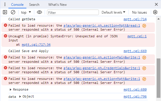

                    • Tico
                      • 31.08.2016
                      • 1035
                      I'm not sure whether it's relevant, but using 'Inspect' in Chrome shows the following error -

                        • 5677
                        #29
                        Permissions are lookin good. Your posted screenshot is relevant - thanks. Can you please have a look into ~/log/system_tmpfs/apache2/php.log when you click on "Save". There must be an error. I fixed some errors here a few days ago and it worked for me. I wonder that you haven't got this fix during installation...

                        • Tico
                          • 31.08.2016
                          • 1035
                          #30
                          Here's the php.log -
                          [08-Dec-2023 14:59:26 Australia/Perth] PHP Fatal error: Uncaught Error: Class 'SQLite3' not found in /opt/loxberry/>
