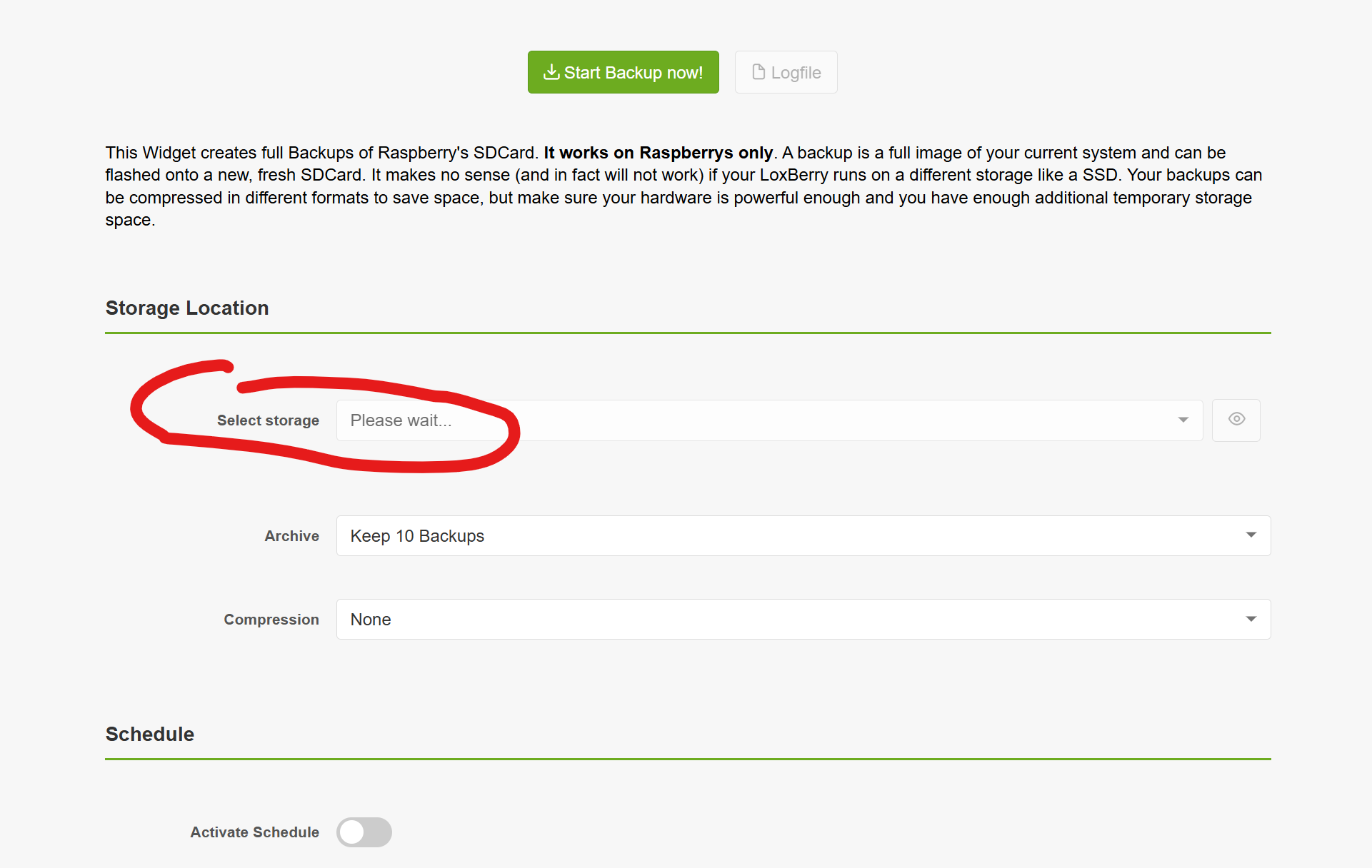

            and the update from 4.0.0.0 to 4.0.0.1 stops the backup function from finding the network share folders - the select storage dropdown is greyed out forever
            i tried removing and readding the netshares but this didnt fix it
            the backup did work on 4.0.0.0

          • duncan
            • 363
            thanks, 4.0.0.2 the backup on pi4 and pi5 works - many thanks for the quick fix
