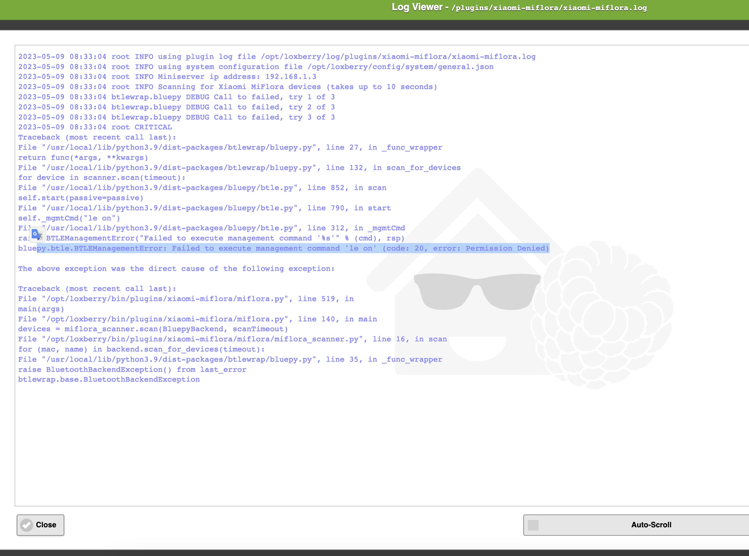

                I've got a issue with it not working and it seems some others have too since 3.x (https://github.com/michaelmiklis/lox...flora/issues/3)
                I'm using a pi4 with internal bluetooth and currently v3.0.0.6 loxberry

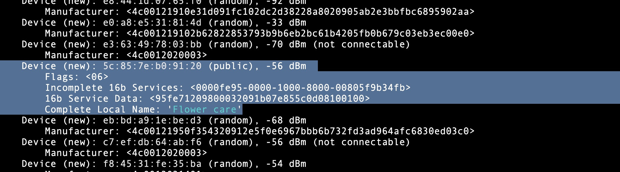

                The devices are found with 'python3 /usr/local/bin/blescan'
Ansichten: 397
Größe: 282,2 KB
                In the log it shows 'bluepy.btle.BTLEManagementError: Failed to execute management command 'le on' (code: 20, error: Permission Denied)'

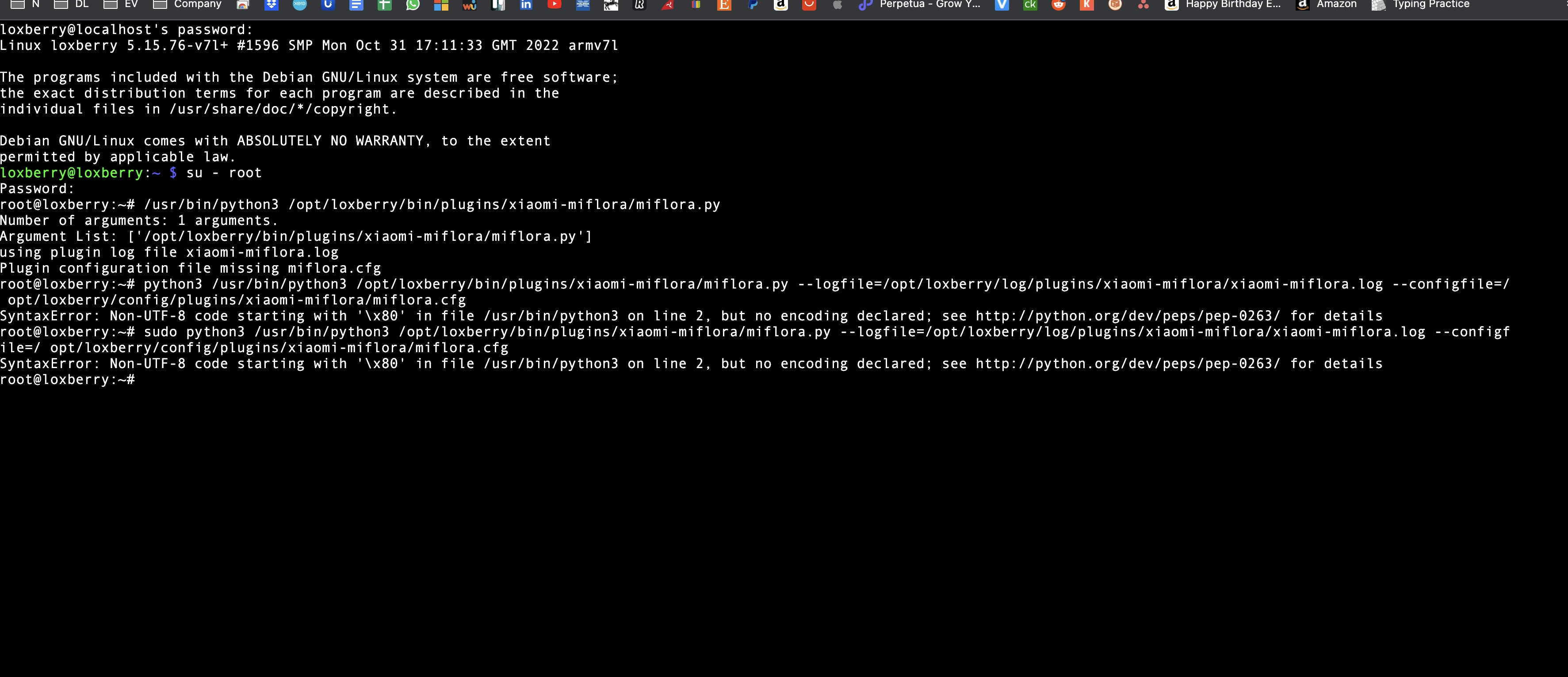

                Also when I try to start the plugin manually It gives me the cfg error
Ansichten: 375
Größe: 577,7 KB

                  Zitat von edipseamm
                  Hey Michael
                  Can you try this in the console:
                  sudo setcap 'cap_net_raw,cap_net_admin+eip' /usr/local/lib/python3.9/dist-packages/bluepy/bluepy-helper
                  • edipseamm
                    • 03.02.2020
                    • 58
                    #146
                    Perfect that worked. Configured UDP and data now comes in
                    ty

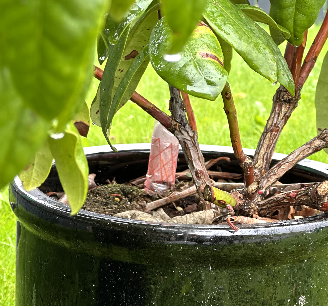

                      Da ich keine bessere Möglichkeit gefunden habe, fertig ein Gerät zu kaufen, dass meine Bodenfeuchte in meiner Wiese draußen zu messen, überlege ich den Xiaomi MiFlora Flower
                      ​irgendwie wasserdicht zu bekommen. Hat das schon jemand gemacht oder probiert?

                        ​I use a bag and some tape. Seems to work. You need to remember to keep them in the bluetooth range
Ansichten: 268
Größe: 3,04 MB

                        I tried some before this MI sensor and this is the best option I found
