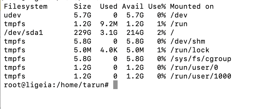

                HDD using don`t fits
                DISKUSED=".11"
                DISKTOTAL=".72"
                Also you have to turn of the inernal soundcard of the Board in the Bios!
                Please give me more infos about your Hardware CPU RAM HDD Typ of Soundcards
                Also send me screenshot from you terminal when execute the follow
                sudo df -h

                  Okay tried a clean install of everything. Still getting lots of weirdness. I attached a new status file.
                  Hardware is ThinkPad 440S to 3x Startech 7.1 USB sound cards with 250GB SSD and 4GB RAM(?). These feed 2x Dayton MA1260 amps which I currently just set to on. This all worked before (I reverted my hardware changes to a different sound card for now).
                  I did blacklist the internal sound cards in Ubuntu. I can try doing it in Bios.
                  sudo df -h output is attached also.

                      Well, I just reinstalled and it is all working now. (1) I suspect somehow I ended up installing on the wrong partition which caused all sorts of problems and (2) there was some permissions issue that resolved itself when reinstalling one of the many times.
