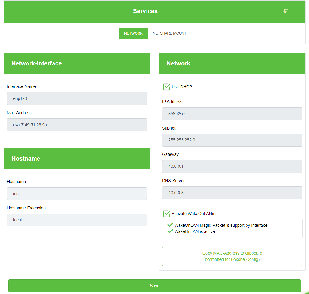

        I am having the port issue intermittently with both servers (the regular one and the one running the 24ao), plus the WebGUI and the networking settings are quite strange.

        • hme0354
          • 06.07.2019
          • 1033
          very interessting IP-Adresse. Maybe thats your problem?
            • 7630
            100% that is also your issue with the not reachable LMS.
            Do you have more than one NIC at your Board?
            If yes, deactivate one.

              Yeah, something weird. Don't have 2 NICs and this server was working fine until I rebooted it.
              Now the webui crawls. Players are not showing on LMS like it isn't connecting to LMS internally either.
              No dual-NICs.
              This is happening on both servers but ethtool and the rest are normal.
