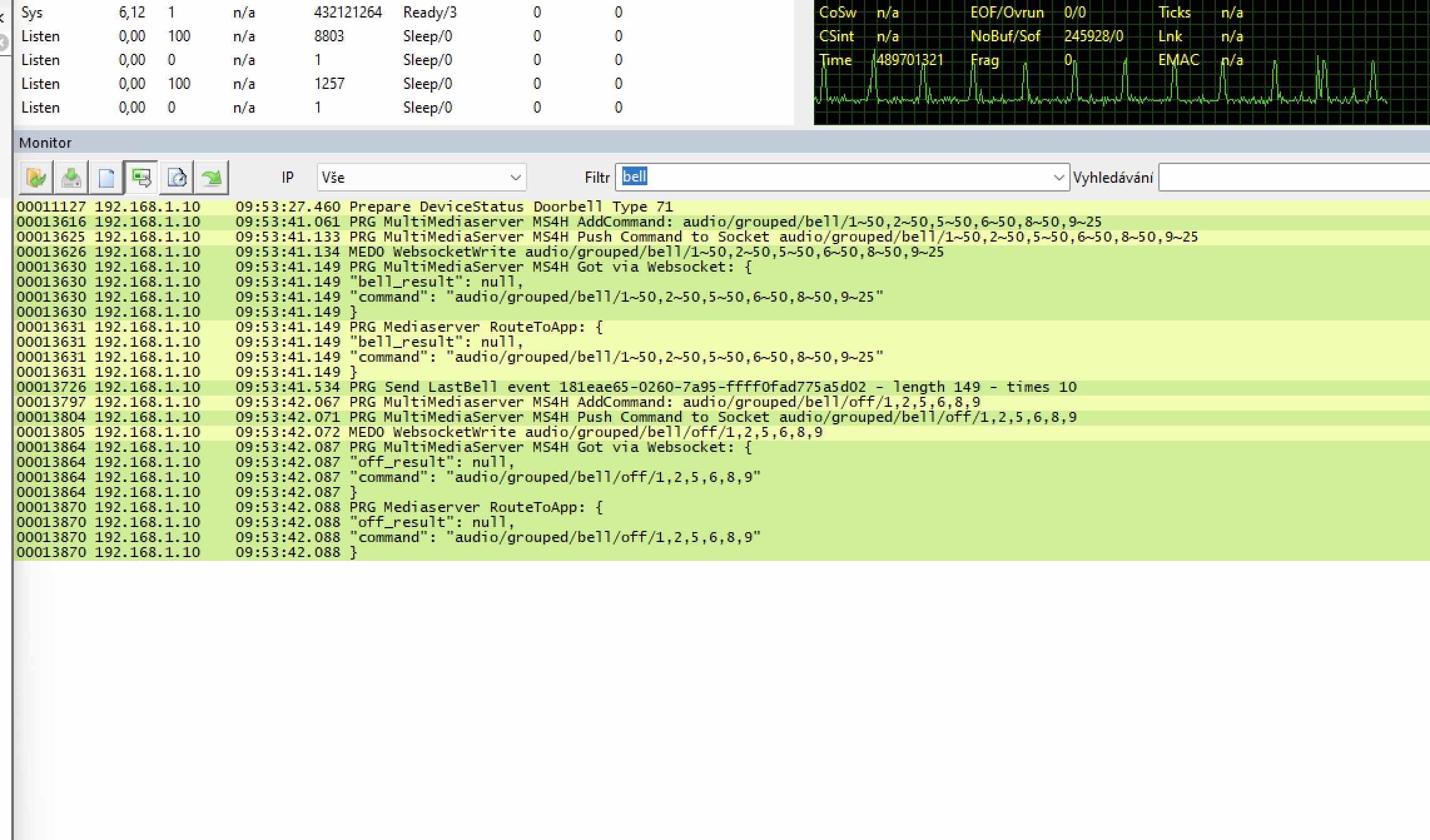

    doorbell doesn't work on my site. Music and TTS works fine.
    MS4H v. 1.5.5.9
    Loxone Config v13.3.2.8
    Log below.
    Please help. Thanks a lot.
    Milos
    Log.
    2023-02-16T11:20:18.842Z MSG:WSCK RECV:audio/grouped/bell/1~50,2~50,5~50,6~50,8~50,9~25
    2023-02-16T11:20:18.843Z MSG [WARN] [HTWS] Unknown command: audio/grouped/bell/1~50,2~50,5~50,6~50,8~50,9~25
    2023-02-16T11:20:18.844Z MSG:WSCK RESP: {"bell_result":null,"command":"audio/grouped/bell/1~50,2~50,5~50,6~50,8~50,9~25"}
    2023-02-16T11:20:19.874Z MSG:WSCK RECV:audio/grouped/bell/off/1,2,5,6,8,9
    2023-02-16T11:20:19.874Z MSG [WARN] [HTWS] Unknown command: audio/grouped/bell/off/1,2,5,6,8,9
    2023-02-16T11:20:19.875Z MSG:WSCK RESP: {"off_result":null,"command":"audio/grouped/bell/off/1,2,5,6,8,9"}​
    • 7630
    Only for the MusicServer-Block implemented not for Group-Events.

      OK ... but .... this event is generated and sent by Loxone Doorbell-block, no by "me", it was working one or two Loxone config version ago. So, next unexpected change on Loxone side?

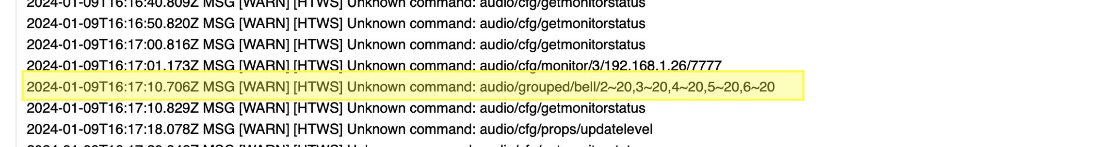

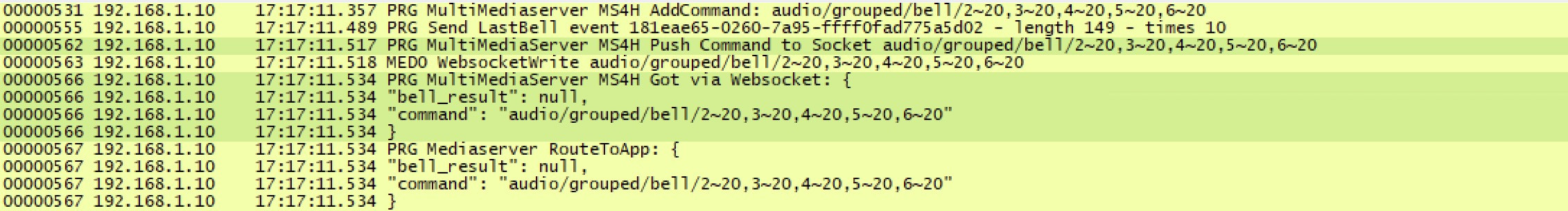

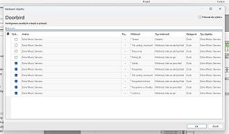

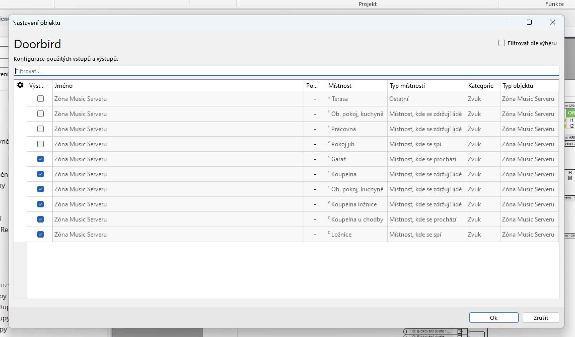

            Hey. Hey,
            another change in the order being sent. Once again, this renders the doorbell unusable
            It looks like MS is sending the volume value in addition to the zone ID.
            Please take a look at this.
            Thank you​

              It has always been like this, even in earlier versions of the Config.
              We already have intergatet the grouped events into the v2 of the MS4H
          • kob004
            • 18.02.2021
            • 12
            .. but the problem is not in the group events, but in the argument that MS4h does not know, like 2~20. Do I understand right that the fix will be in v2? Thank you
              Group event for me are for me only a array of single events.
              Yes we fix that with v2
