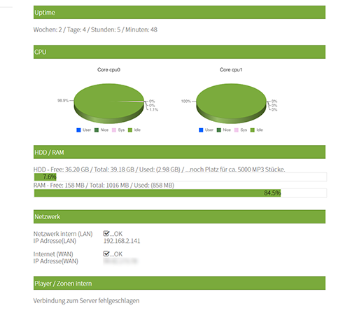

                    Hi.
                    I have installed your system on QNAP in virtual machine - it works well.
                    After installing version 0.4.8 and then 0.4.9 on status page I get information:
                    Verbindung zum Server fehlgeschlagen
Name: Zrzut ekranu 2017-06-13 21.15.09.png
Ansichten: 187
Größe: 53,4 KB

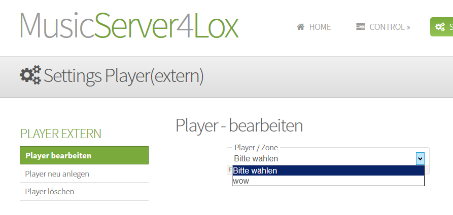

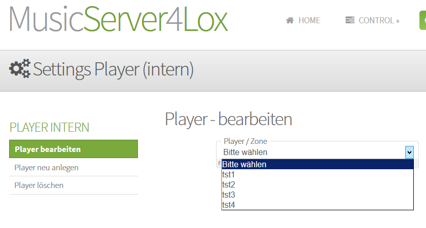

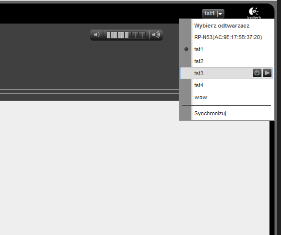

                    All players work well (internal and external) - I can play music in LMS and players are listed on SETTINGS/PLAYERS page

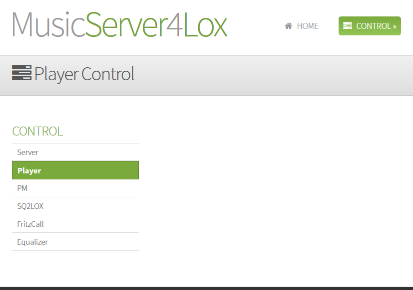

                    There are no players listed on CONTROL/PLAYERS page

                    Maybe You have any idea where might be the problem.
                    Thank you very much in advance
                    szymek
                      • 7663
                      That happens when the php-config-file could´t not be read.
                      The fastest solution is to save all settings again. It looks like that a .cfg file is not there or readable.
                      all = player ... tts ... fritzcall... lms .......
