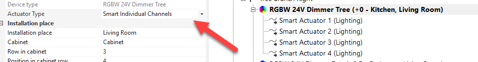

    • What is the Actuator Type that I should choose for the RGBW 24V Dimmer Tree?
Ansichten: 2383
Größe: 22,2 KB

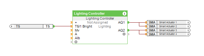

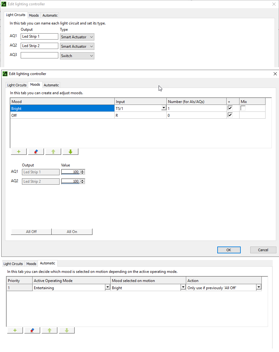

    • How does the configuration take place in combination with the Lightning Controller?
      Is what has been configured below correct?
Name: Lightning Configuration 1.png
Ansichten: 3985
Größe: 13,7 KB
ID: 193134Klicke auf die Grafik für eine vergrößerte Ansicht
Name: Lightning Configuration 2.png
Ansichten: 2607
Größe: 39,2 KB

        • "What is the Actuator Type that I should choose for the RGBW 24V Dimmer Tree?"
          => Need to be Standard Individual Channels instead of Smart Individual Channel in case of regular led strips
          Click image for larger version  Name:	RGBW 24V Dimmer - Actuator Type.png Views:	0 Size:	16.8 KB ID:	193241

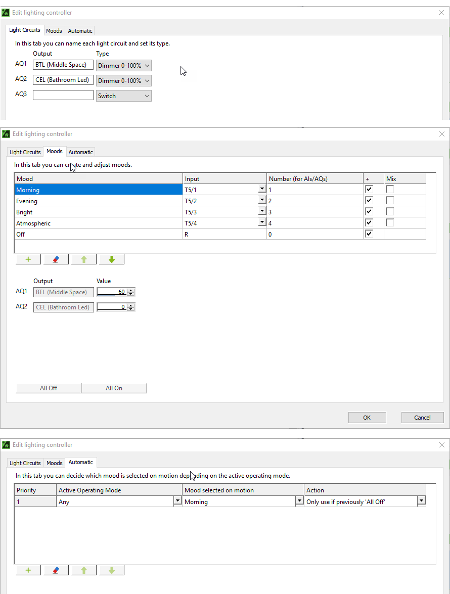

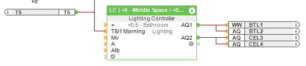

        • "How does the configuration take place in combination with the Lightning Controller?
          Is what has been configured below correct?"
          => Instead of the "Smart Actuator" Type, "Dimmer 0-100%" should be used as type
          Click image for larger version  Name:	Lightning Controller.png Views:	0 Size:	11.6 KB ID:	193242Click image for larger version  Name:	Lightning Controller - Settings.png Views:	0 Size:	46.8 KB ID:	193243
        Hope this helps anyone else wondering what the configuration should look like
